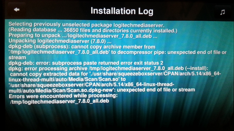

Just had another go with a 4GB stick and when trying to install LMS I'm getting the error:
Errors were encountered while processing: /tmp/logitechmediaserver_7.8.0_all.deb
Having done a search on this forum, it seems the Linux partition may be a bit small.
Is there an image file that can be downloaded that's suitable for 4GB sticks with a partition big enough?
I've spent a good number of hours trying various bits of software such as Minitool Partition Wizard and Paragon Partition Manager and they both refuse to make my ext2 partition any larger.
GParted seems a bit complicated to use.
I'm surprised not many people have noticed this issue with the lack of space.

vinnielo wrote:
gegs wrote:Try with a bigger USB stick than 2GB (heck, do they still make 'em that small?)
I use 8GB Sandisk ones and I've not had a problem installing LMS.

OK, I've now reluctantly used GParted and have managed to get 3GB on my Linux partition.
Unfortunately, I'm still getting the errors on installation of LMS.
Photo of log attached.
Any other ideas?

vinnielo wrote:OK, I've now reluctantly used GParted and have managed to get 3GB on my Linux partition.
Any other ideas?
Well, as It has previously been possible to load LMS on the Joggler internal ram, and those version onto an external stick without using gparted, you gotta be doin somtink wrong.
Whynot reformat the stick (HP Tool) and install the external image again.
There is no reason why it shoulld not work,atall :roll:

Well, if you could get me a pre-configured SqueezePlay OS 4GB stick (with unallocated space made available for music storage), then there could be a beer in it for you! :)

vinnie,
Right, found an external 16 Gb usb stick.
Installed Squeezeplay and LMS v7.8.0 and expanded the root partition to 3.9GB.
Playing BBC Radio 3HD at the moment and also tried Radio paradise 320 stream, both OK.
Remaining 10GB partition is formatted with G parted to Fat32 but my Windows 8.1 will not recognise it.
Going to make a Linux MINT boot CD and try to put a Music folder on that (any advice is appreciated).
I have a Windows 7Pro and XP I can try with at the weekend.
Do you want EDO on the Squeezeplay?
Also, do you want LMS v7.9 and would you like me to configure the LMS with the BBC iPlayer and BBC iPlayer Extra plugins, Spotify, Podcasts, NPR, or do you want to do that yourself?
atb
Ronnie
