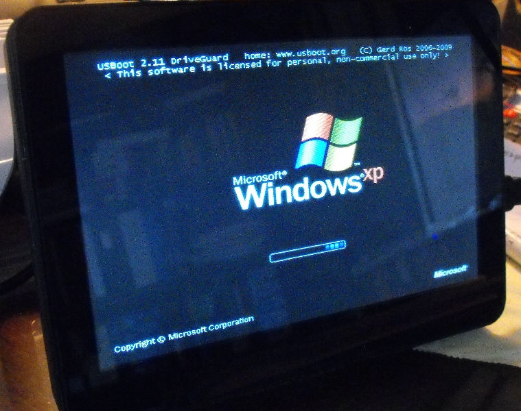

Swapped out the NTDETECT.COM & ntldr & vga.sys files. Tried to boot via external USB port; no go there. Plugged in the ZIF USB drive on the internal port and it appears to be booting. Looks to be just though just sitting at the booting part though.

Connected a small 4 port on the side port. Starts to boot as picture above. It just sits though with the blue bar going across. No errors or BSOD's though. Wonder if it has to do with the USBoot 2.11 Driveguard. I don't recall seeing that before when using it with the EFI boot.
Testing above with no keyboard or mouse plugged in. Will try again with a keyboard and mouse plugged into the internal port.
Same result with a keyboard and mouse plugged in. I am seeing the 2nd hub port LED light flickering while booting.
I see the led flicker of the Zif drive when first starting the boot but after a bit it just remains on with no flicker.

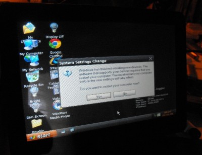

Hit the F8 while booting to go to debugging mode. This time it started to complete the booting. Went to an invalid system time and my keyboard and mouse quit working.
Waited a bit an it appeared to load the mouse drivers. It went to a desktop! Yeah!
Screen resolution looks good. Loading a bunch of drivers now; pci, audio, video, etc. Rebooting.
Can't get it to reboot now. Going to do a chkdsk on the drive as its an old ZIF drive.
