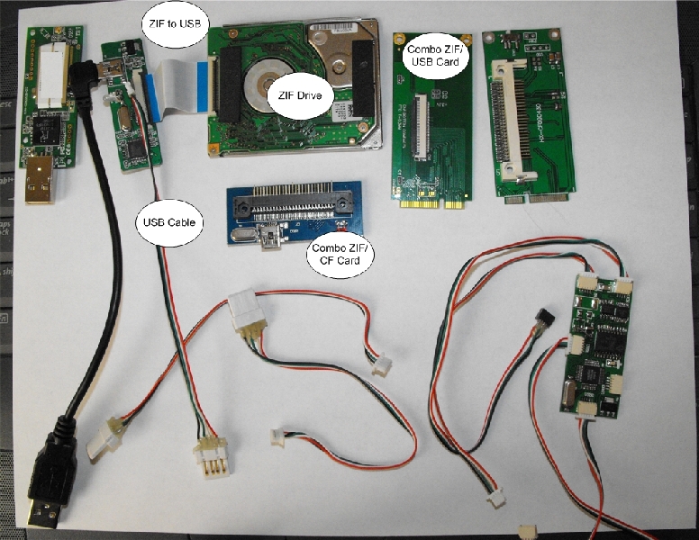

Re: BUILD 2 - Windows XP Professional SP3 (Plus Tablet PC)
Here's a picture of the pieces of HW I have to play with. The ZIF drive is the largest. Its thin. I'm wondering now if they make smaller ZIF drives these days?
Verg0, I was able to fit the ZIF drive inside; but it involves some quantum physics; little tiny particle accelerator and a "flux capacitor".
You don't even know its inside of the Joggler.
So really best right now is the SSD USB stick. Maybe a 16/32 Gb one would be better though inside of the Joggler.
Now that I have taken apart this one though will be putting the USB SSD stick inside anyways. Boots fine with the both of them in the USB ports.
