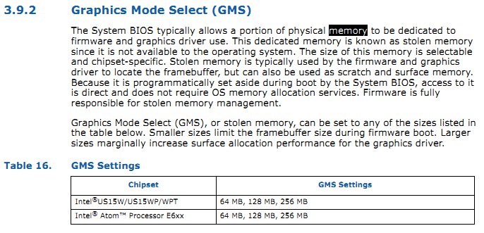

Here's the info in the EMGD driver documentation which relates to stolen system memory.
Re: Coreboot and SeaBIOS
Man, what the heck is Intel on about. GMA500 only has 3 options for stolen memory size: 1MB, 4MB and 8MB. I picked 4 because 8 is complete overkill for an 800x480 FB. Guess that's going to have to go on the reading pile.Mevi wrote:Here's the info in the EMGD driver documentation which relates to stolen system memory.

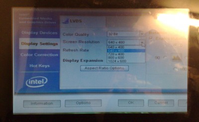

I had a go with some existing drivers off the net and this is what I got, no 800x480
I had the same luck with ones I downloaded before I made this one. I'm drawing a blank looking for scaling options in the driver config or in the included documentation. Googling hasn't got me any further, but I'm still looking.

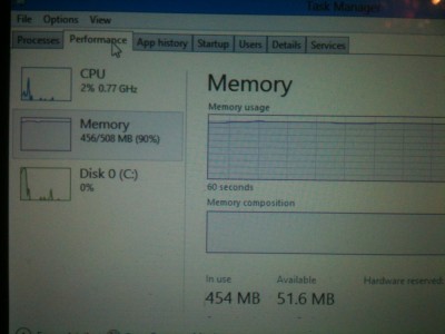

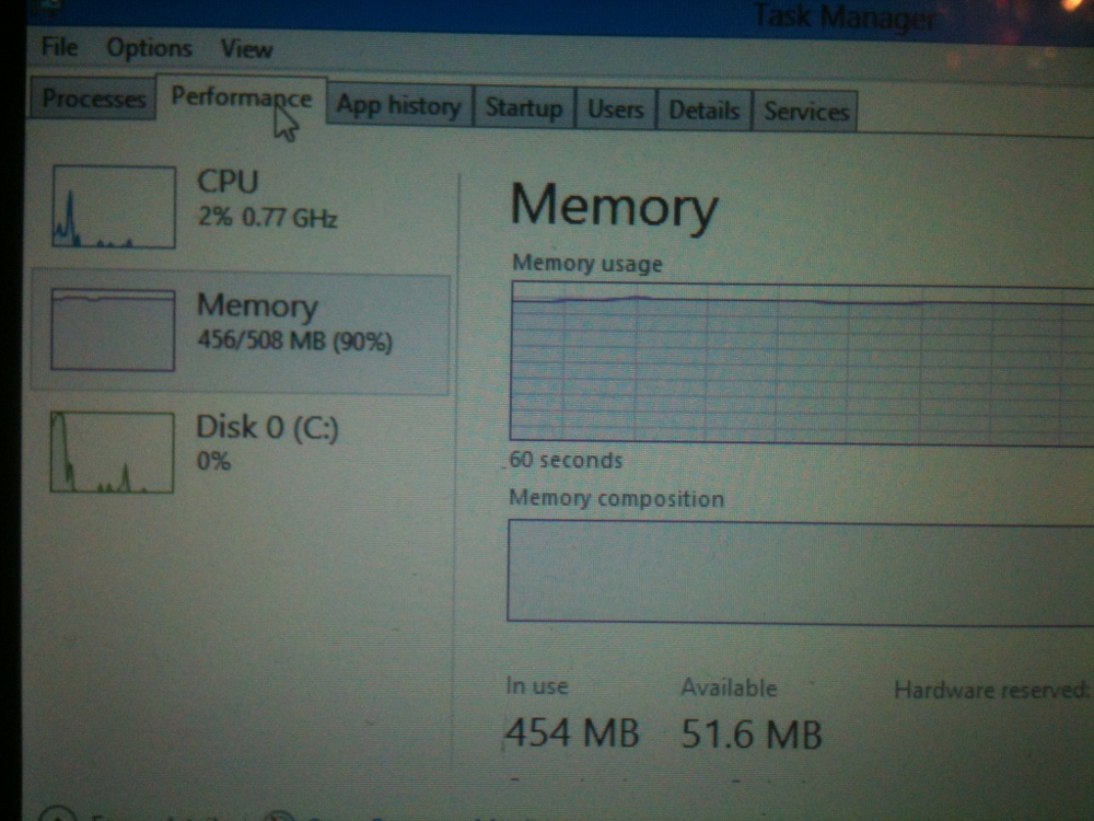

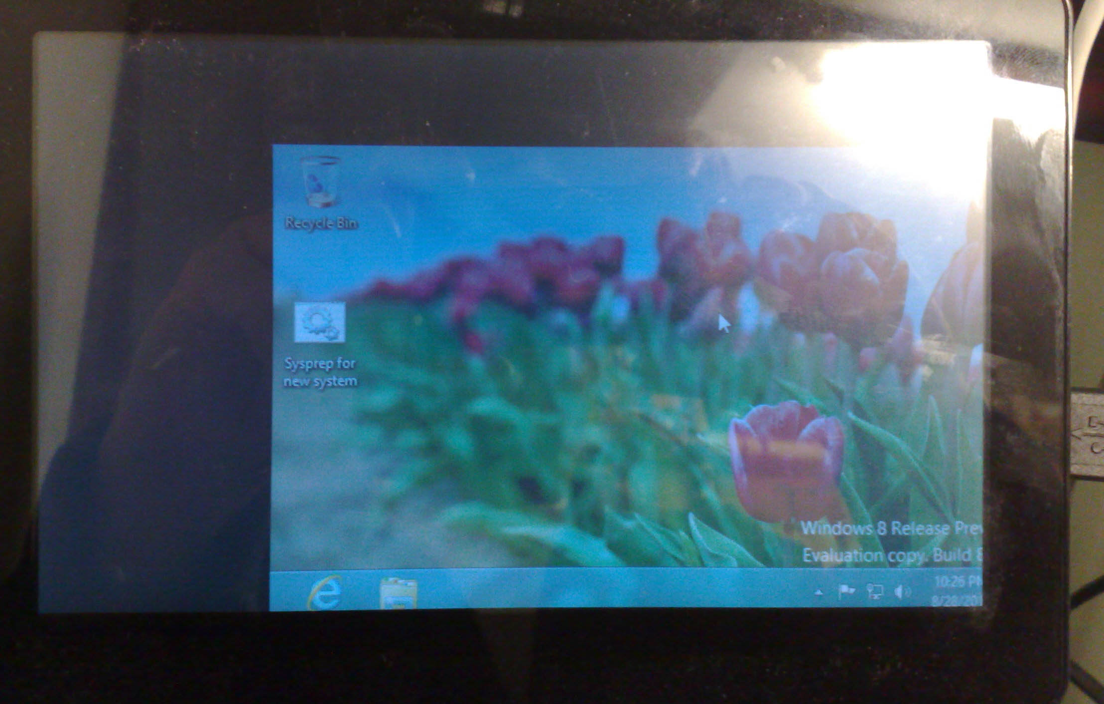

Thanks Inaxeon. I flashed with coreboot_emgd.rom. It might just be me, but the W8 GUI seems a lot more fluid. Switching between desktop and metro is quicker than it was earlier today. Aside from flashing the rom, I've done nothing else. Display properties show 64MB system memory. It still bluescreens 'page fault in nonpaged area'. Looking at the minidump, they are all kernel errors:
At idle, with nothing but the task manager running, it's using around 450MB memory in use. I'll rebuild using Mick's method and see if that cures it - From his screenshots I can see he's using the pre-release preview, whereas I'm using the RTM.
082612-33477-01.dmp 26/08/2012 00:36:09 PAGE_FAULT_IN_NONPAGED_AREA 0x00000050 0xfffffff4 0x00000000 0x8110cdd8 0x00000000 ntoskrnl.exe ntoskrnl.exe+f7cb0 NT Kernel & System Microsoft® Windows® Operating System Microsoft Corporation 6.1.7601.17835 (win7sp1_gdr.120503-2030) 32-bit ntoskrnl.exe+f7cb0 ntoskrnl.exe+3a585 ntoskrnl.exe+16e654 ntoskrnl.exe+fbdd8 C:\Windows\Minidump\082612-33477-01.dmp 2 15 9200 142,112

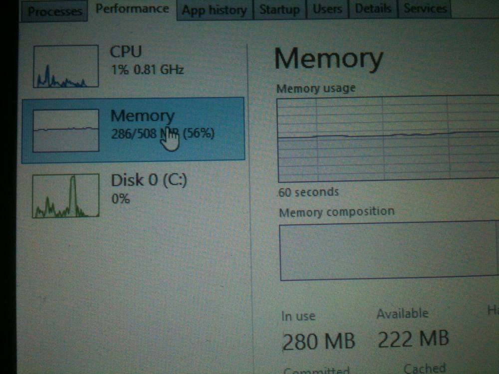

Started again clean & using the EMGD video BIOS:
Yep, using the MS driver the total memory usage is around 280-290MB. Rebooted a few times to be sure. Desktop/metro switching scrolling is smooth. After installing the EMGD the memory usage immediately jumps up to 430-450MB. Rebooted once OK, but next reboots resulted in the familiar bluescreen. Lots of HDD thrashing. I wish Openpeak gave the Joggler more RAM. It's interesting to see the Atom processor's Ghz speed up and slow down in realtime.

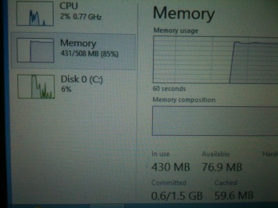

I unticked the hardware acceleration and made a new driver installer. The memory usage was no less than with acceleration. Lots of disk thrashing. Still had the bluescreens when shutting down too. Uninstalled EMGD and back to the VGA, memory use down to mid-200s again.

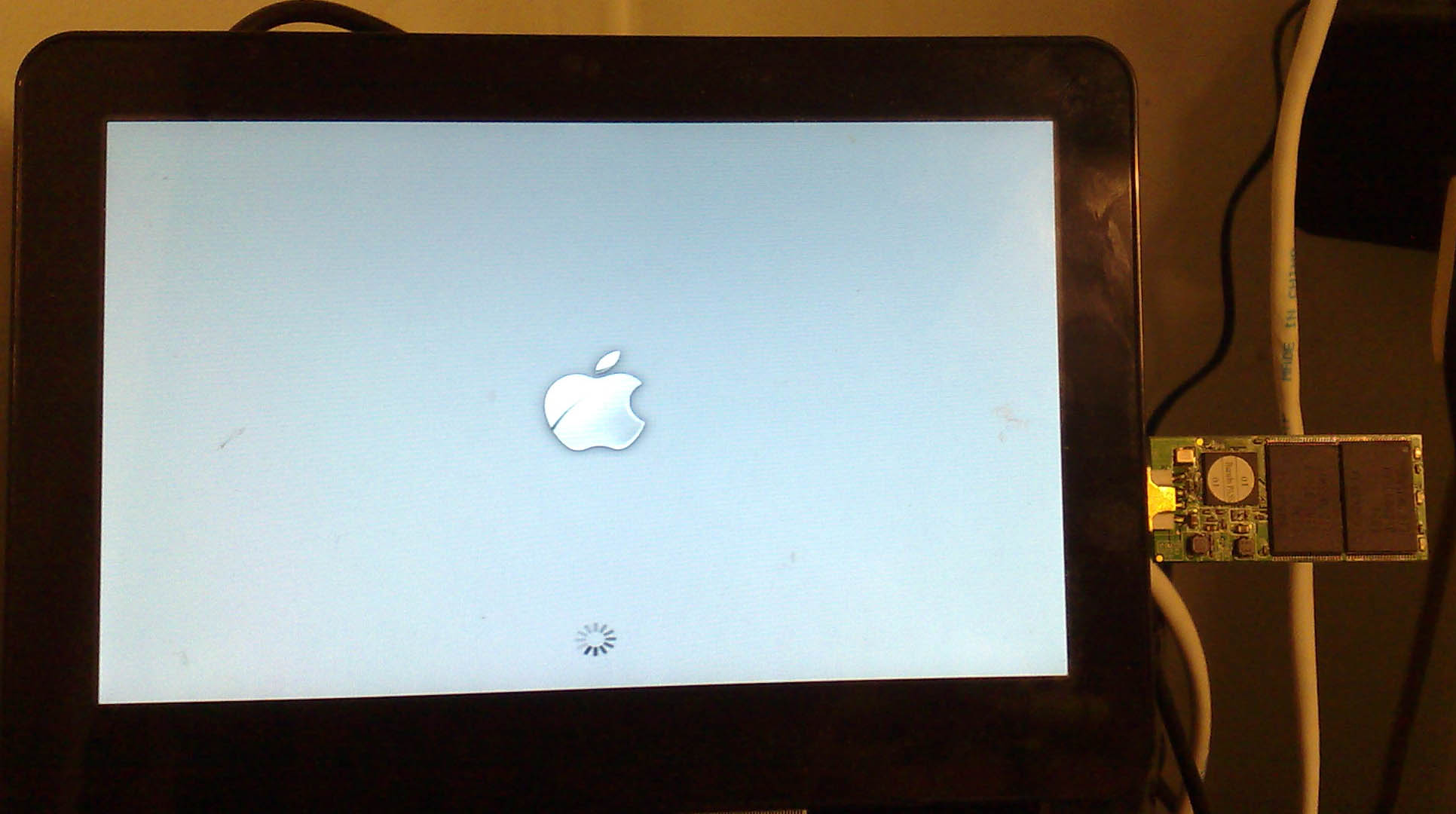

OSX leopard, I think it is just the video on the joggler stopping me getting it working.
I did an install of Leopard 10.5.7 on my Q1 Ultra on to a stick and removed it before it rebooted,
put stick in joggler and booted. At the time I had my keyboard and qsb speakers plugged in,
after a few minutes of the apple logo with spinning dots I got the welcome music through my speakers
but no video so can't get any further yet. Will keep trying.
