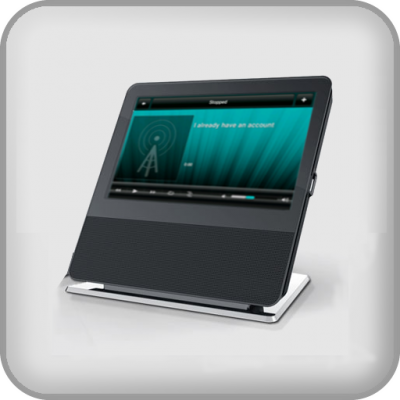

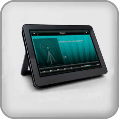

If you like to have a nice image of you Joggler included within the LMS settings page like this:
LMS Player-Settings (HTTP)
just copy the attached PNG (OpenFrame1.png) to your LMS Server:
/Squeezebox/server/HTML/EN/html/images/Players (Same directory where baby.png can be found)
Edit on your device:
/opt/squeezeplay/share/jive/jive/slim/LocalPlayer.lua
search for:
local DEVICE_MODEL = "SqueezePlay"
and change to:
local DEVICE_MODEL = "OpenFrame1"
or
local DEVICE_MODEL = "OpenFrame2"
Alternatively to editing LocalPlayer.lua you could install/deploy the little applet I have attached.
Just copy the files included in Applet.zip to
/opt/squeezeplay/share/jive/applets/JogglerUpdateModel/
