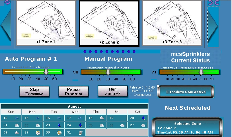

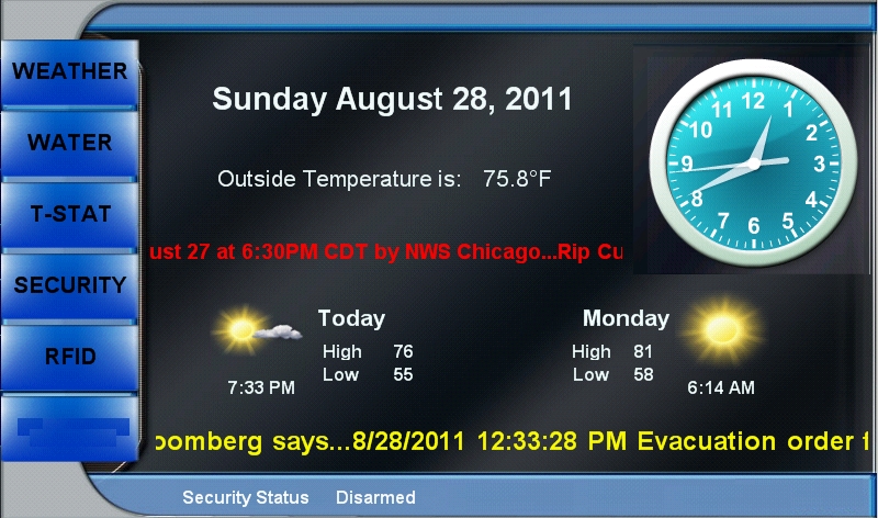

I am currently trying a "do all" setup with the Joggler. I am into home automation; so one view is just multiple touchscreens to the HA system.

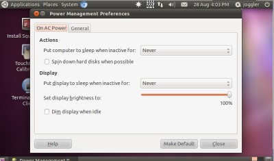

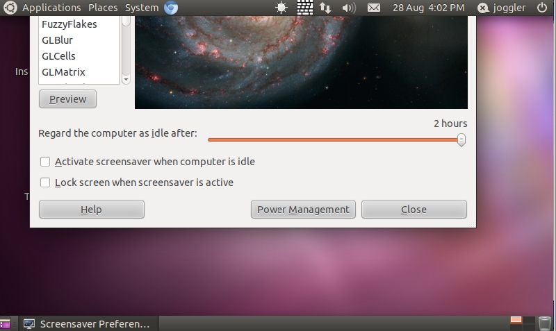

Been trying to keep the Joggler from falling asleep as I would like to manually just maybe use a cron job or remote it such that the display dims. I currently just shut off the backlight on another gizmo that I play with. (via the display interface or remotely).
Just curious what others are doing to keep their Joggler's displays from going to sleep?

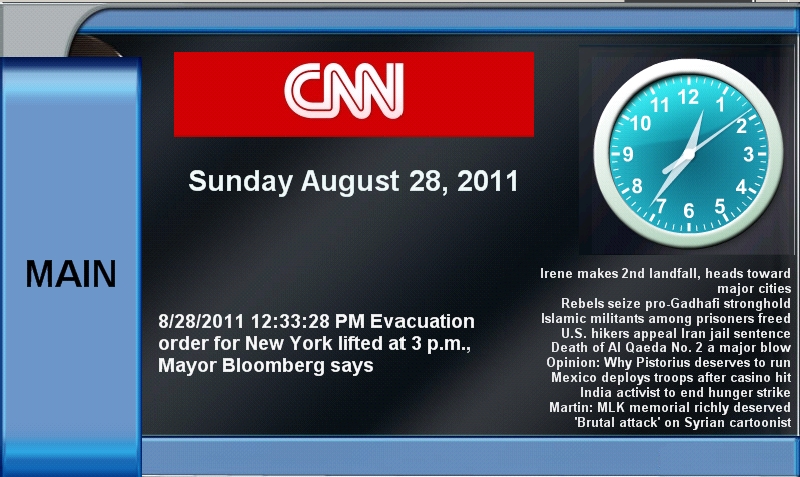

Attached is a news alert that just came up on the Joggler. Basically the HA server does a CNN/BBC screen scrape looking for headlines. When the top "hot" headline comes up as a "news" alert; it sends it to a screen on the Joggler; leaves it there for about 5-10 minutes; then moves to a basic main screen with a scrolling news event alert.

Joggler Sprinkler System
Joggler main touchscreen
Joggler CNN news alert

there are two configured screen values. one is the time to turn the screensaver on (set to blank screen on ubuntu by default), the second is the time to power off the screen. to configure them, go to "system menu" -> prefs -> screensaver. and you can untick the "activate screensaver when computer is idle". for the display switchoff, on the same app, you can click "power management" and there is a setting display "put display to sleep when inactive for:"and you can choose never. the screen will now remain on permanently.
if you wish to manually switch off the screen, the console command "xset dpms force off" from a script or something should do the trick.
hope this helps.

Thanks BuZz. Tried the GUI stuff and its still doing it. BTW had a Commodore C64 in 1982 or so, then a C128 and Amiga Computer. (am a bit old now).
So I went to the command line: help shows:
To control Energy Star (DPMS) features:
-dpms Energy Star features off
+dpms Energy Star features on
dpms [standby [suspend [off]]]
force standby
force suspend
force off
force on
(also implicitly enables DPMS features)
a timeout value of zero disables the mode
did a
xset dpms force on
on the terminal of the Joggler.
Re: Ubuntu for the O2 Joggler.
not sure if you are saying something didn't work or it was fine ?
Originally the GUI entries appeared to have no effect; the screen would go to sleep.
The command line you mentioned did work. (xset dpms force on)
The screen has not gone to sleep. Thank you BuZz.
