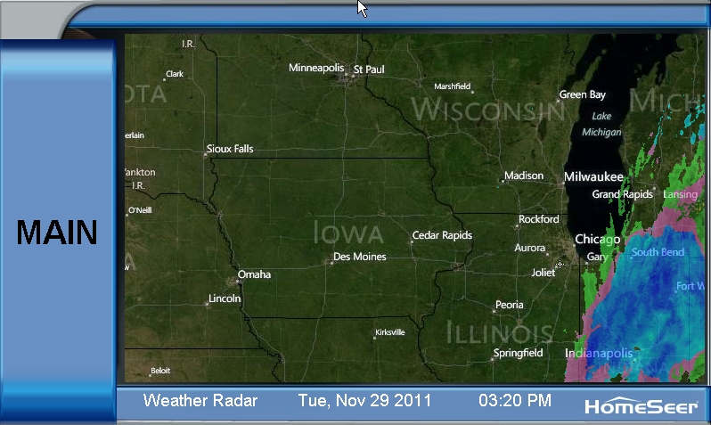

I noticed an odd boot sequence with the newest Joggler. It keeps repeating the INT section with the same line a few times before proceeding. First time I have seen this. Once booted (Dan's XP3) then all is OK.
Another thing I noticed is that the capacitance screen is way more receptive than the resistive screen. I have a Liliput 8" resistive screen next to the Joggler. The touch on the resistive screen is not nearly as nice as on the Joggler. Response times are also better with the capacitance screen. Attached is a combo moving map that you can play with. You can drag the map, close in or out on it...but its kind of a neat test for the touch screen. Similiar to doing the hand jestures on the Android, WMobile or Apple. Will post the html as soon as I find it. Its very old and primitive; still using it. Stick it on your apache server.
The blue stuff is snow BTW. Windy and cold here today.
Personally mine would freeze there if I left the NIC plugged in. If I removed the NIC it would boot fine. I would sit and watch the LED blinking. If it got to the 1/2 screen and the LED kept blinking; it was booting; if the LED stopped blinking then I knew it had locked up.
