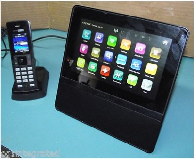

Received the above mentioned OpenPeak II device today. This device was definitely utilized. (well worn).
It came with an original OpenPeak black box with no other telco logos. The OpenPeak DECT phone is smaller than the other one that I have. The menu has stuff like restaurants etc. Looks like a doo all phone touchscreen type thing. It even came with a couple of manuals. Very impressive.
I will take pictures.
