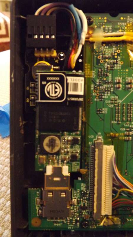

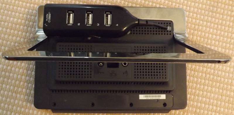

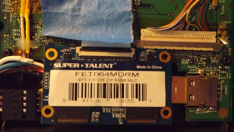

Here is the test Joggler that I am using.
Years ago found that the true USB SSD drive worked the best. The ones that I purchased came in large plastic cases such that I removed the case to fit them inside.
Also is a picture of the 64Gb SSD IDE MLC drive. I have had issues with this drive and removing it and trying a low level format and fix on it as I have had many issues with it. The stock SSD drives that I have used are 16 or 32Gb. These work fine.
Also in the pictures notice the tiny RTC in the top left hand corner. This works fine. Note too that the case closes fine with the three devices on the left hand side. The other Jogglers I have just the WLAN card and a 16Gb SSD. Been fine here for years.
Costs added up though relating to the SSD drives which prices are all over the place.
The OP2 does have a battery / rtc. The OP2's and OP1's and O2 Jogglers had a blank non programmed realtek NIC chip. If you program the NIC chip with a MAC address and configuration it will be better. The real SSD USB stick works great. Here a few years ago modded a seagate dock star and initially used two USB stick booting to linux. After about 6 months the USB sticks got trashed so went to using SSD and never had a problem with it afterwards.
This picture is just showing how the SSD card is over the USB SSD card with the RTC on the top and I have no issues here closing up the case. The ZIF cable is long and folds on the motherboard and works fine.

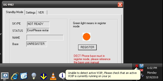

If you have any jogglers with Dect running windows you can try this software and see it it detects youyr headset...
http://www.mediafire.com/file/d0rczax58 ... 902-EN.zip
Re: Firmware with DECT support.
Yes here have 15 Jogglers / OP's running XPe.
Tested software and it shows a USB disconnected on start and a couple of errors.
-=xXx=-
Posts: 147
Post by -=xXx=- »
did it install any driver is dect detected under Xp?
No it did not install any drivers.
First message is that the USB port is disconnected. It comes up fast then goes to the error message above. I am testing with a new Openpeak DECT phone fully charged.
