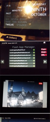

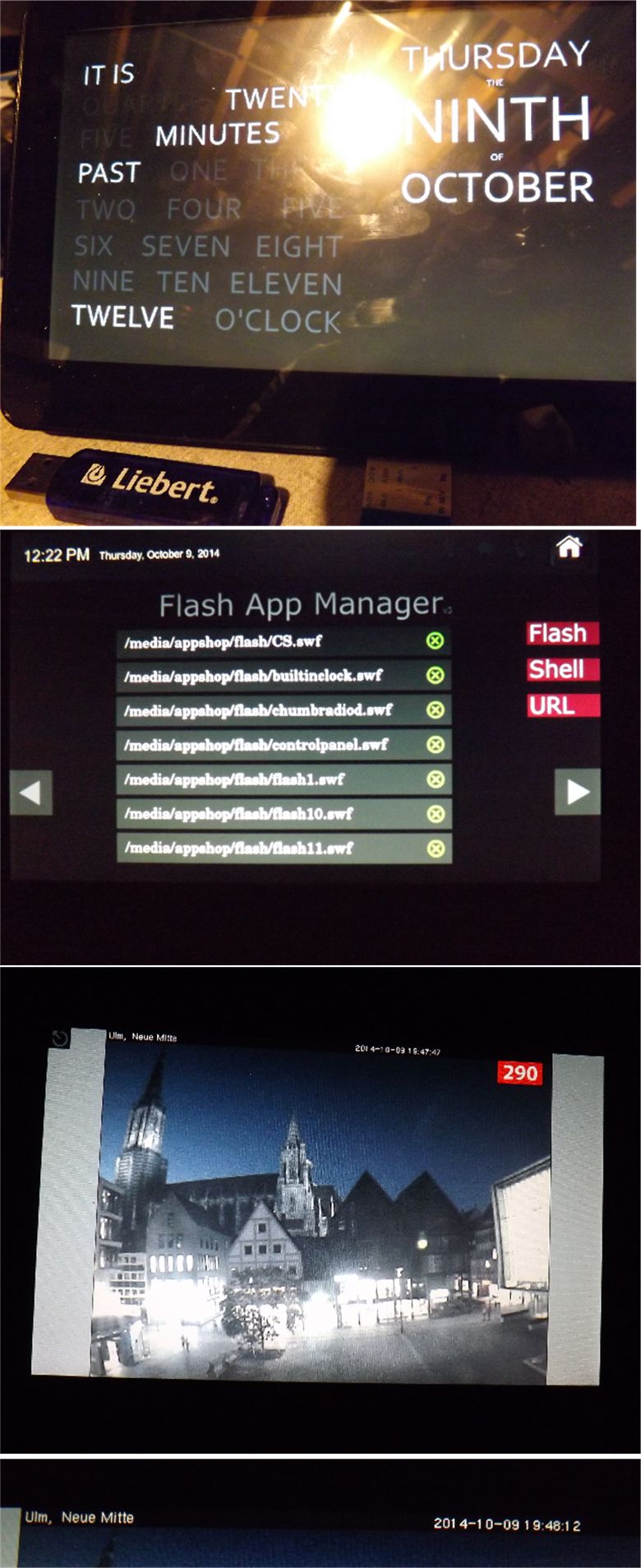

Works fine on the Joggler. I needed to wait. It showed that it was loading for a few seconds. Only thing is the 4:3 cropping that is noticeable.
I wonder if its that cross scripting thng. Here is webcam picture.
I think the sun has set by you now eh?
