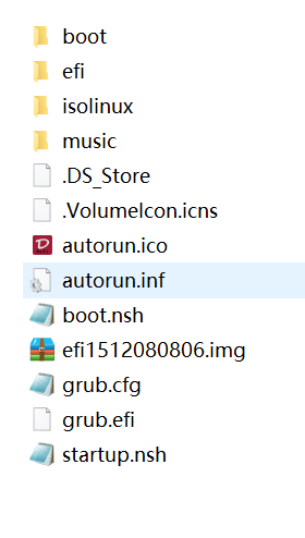

OK,use the 32bit version, but still stucked, do I need to move the EFI file to the EFI folder ?mickchip wrote:You have to use the 32 bit iso the Joggler has a32 bit cpu.
there is 5 files in the zip, put all in the root folder?
thanks
- Image 2.png (5.48 KiB) Viewed 14804 times

Yes put them all in the root folder, it worked fine on mine. Try a different USB stick jogglers can be quite picky about these.

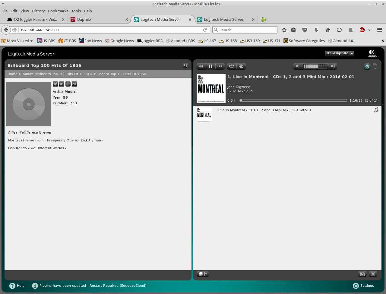

HTML screen grab #1 with HP USB stick boot (slow).
Edited the settings to see if it would see my LMS server and enabled player settings and it looks like the SP stuff now on the Joggler.

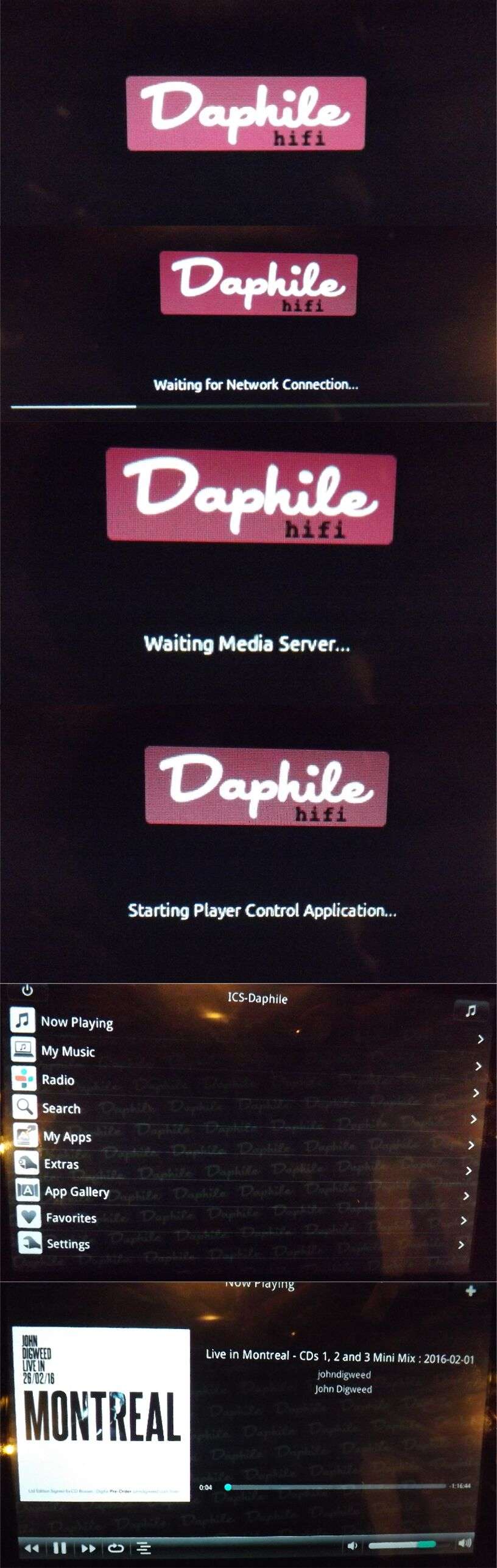

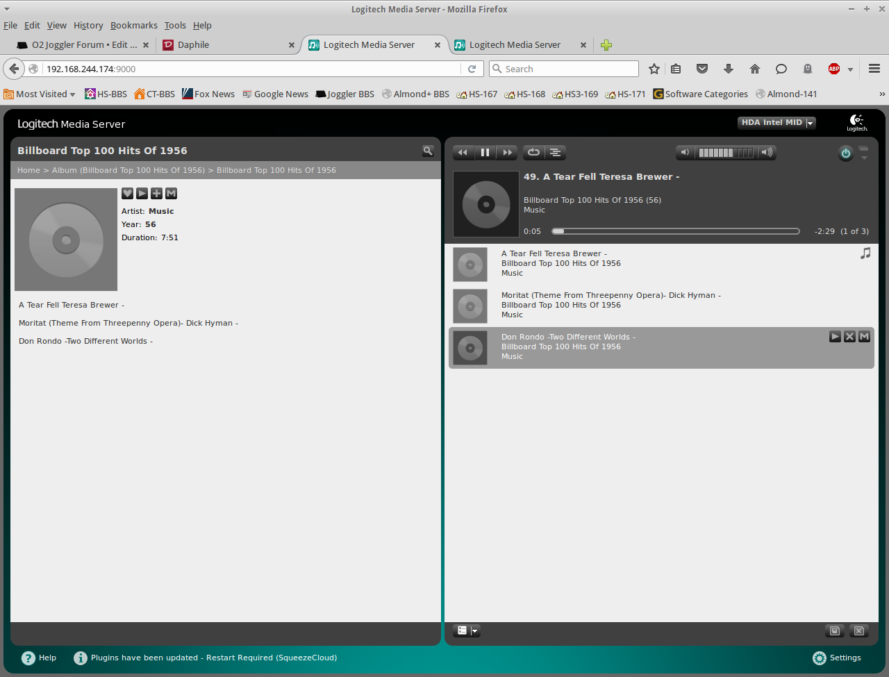

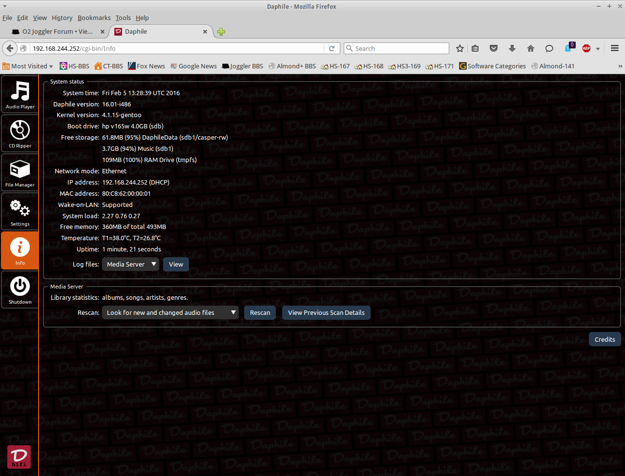

It now boots to the Daphile Squeezeplayer application and it saids HDA Intel MID on the top. No sound yet and touchscreen is a bit off.
OK got it playing streaming internet audio fine. Now trying to get it to play my LMS NAS music.

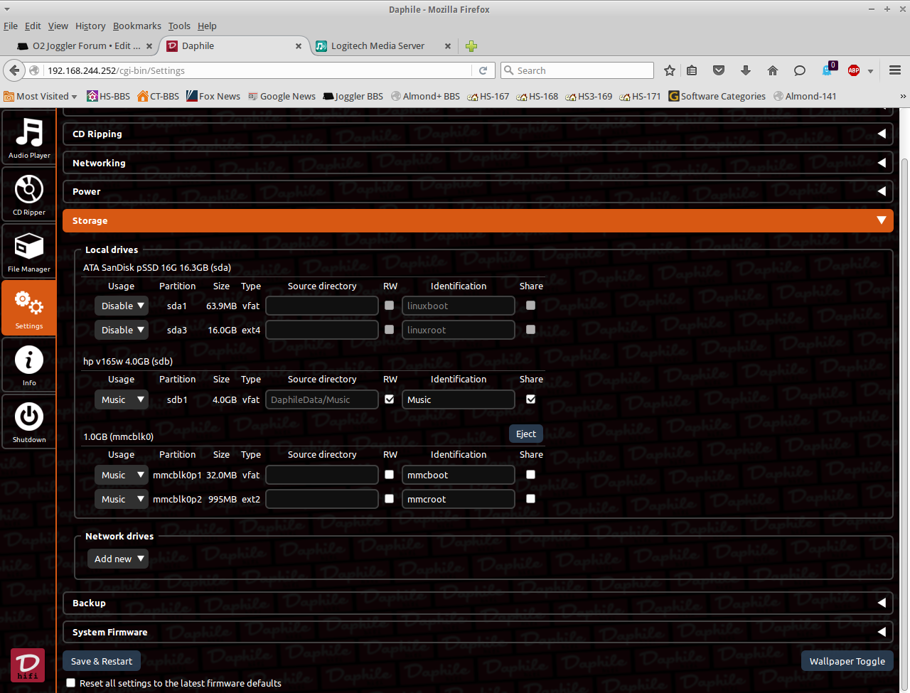

Drives available

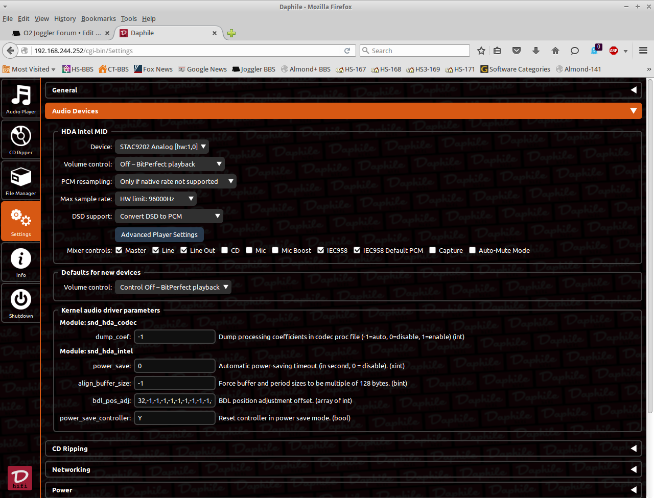

Audio devices
LMS server showing what is playing ...

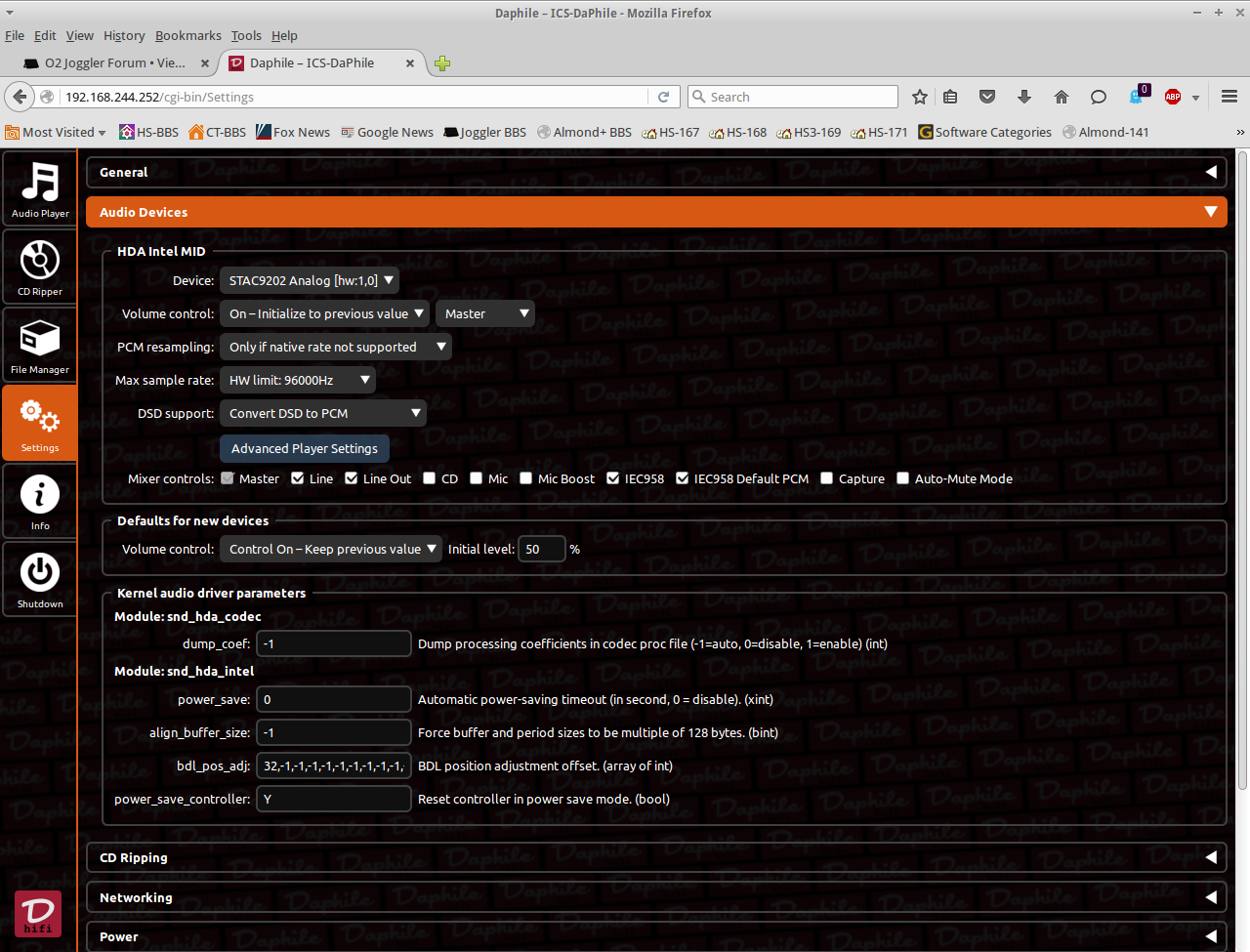

Made a bunch of changes to Squeezeplayer stuff on O2 screen. Looks like everything stuck except for the fixed audio setting to 100%.
Got the audio adjustments working fine now. Here are the settings I used. It saves them fine on a reboot.

Here are pictures of the Joggler booting up Daphile.

next I tried it with two USB hubs but no dice , it would not boot .
Has anyone tried it on internal memory yet ?
Daphine would be nice on internal with an external CD drive and ext HDD attached for ripping CDs ( one of its features )
Re: Hi-Fi system on Joggler
It is very much like a Squeezeplayer server clone. I think it would work on the internal memory.
Just edit the EFI text boot files so they look the the MMC boot ones. It would just be one directory / partition. Booting with Linux just wipe the partition. Format it. Copy the files.
I'll give it a try here. Playing with a beta test right now.
