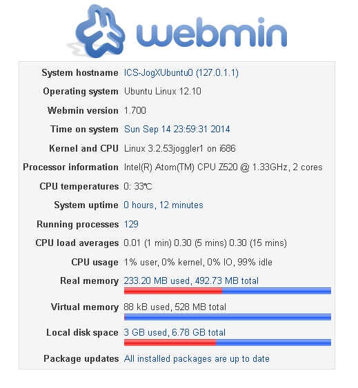

I had a look at the SP as I don't remember how I set it up.
This Joggler is running Buzz's Xbuntu 12.10 build and booting into SP when it starts.
It is using an SSD USB stick and it has no ZIF PATA drive. To fit the SSD stick I had to remove it from the case and replaced the wireless card with the USB stick.
So taking back what I said before about running it on a PATA SSD; this one does fine with an 8Gb USB SSD stick cold booting and rebooting with no issues.
I do need to update it to Buzz's latest Ubuntu build as the rest of the Jogglers are now running it and doing well.
Webmin is showing that it really doesn't work too hard.
root@ICS-JogXUbuntu0:~# df -l
Filesystem 1K-blocks Used Available Use% Mounted on
/dev/uba3 7048052 3129364 3918688 45% /
