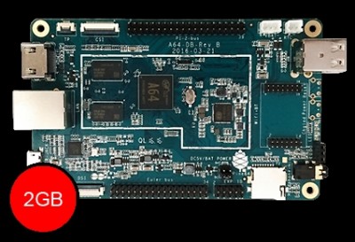

The Pine64 2Gb machine runs faster than an RPi3 today and priced right at $27.00 USD The WLAN / Bluetooth card is a modular add to the device. It is bigger though than the RPi computer.
