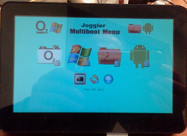

Hi All
Here is a a pic of my multiboot menu, when I have cleaned out all the not needed files and tidied up a bit I will upload my mmcblk0p1 files and a how to.
Multiboot off the jogglers efi partition using reit with a plugged in keyboard.

Awesome. Thanks Mick.
Re: RELEASE - Windows XP Professional SP3
I nearly wet myself with excitement, wow, hope i can work through your tutorial when finished without too many cries for help :?:
i have been looking for something like this for ages, congrats in order for working it out ,well done that man

Very nice MickChip!!!
Nice mick, seems as though i will have to get a usb keyboard now lol
