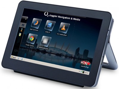

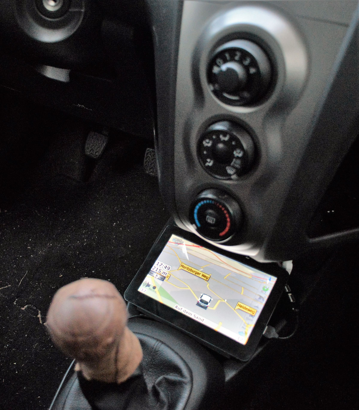

Hi everyone;
I like the XP-Nav system so much in my car, I wanted to share a picture.
I removed the Joggler stand (So far, heat dissipation is no problem) and the system sits snuggly rigtht in front of the gear shift - very good visibility from the drivers seat.
Also, a note regarding crashes when cranking the engine: With the 2000µF caps alone, I still get about 1 crash with every 5 engine starts.
Now, I added ferrite cores: 1 in the 12 V line (in front of the power adaptor) and 1 in the 5 Volt line, right at the Joggler.
So far, this looks promising.
Also, I use the Joggler in this setup as an MP3 Player via Windows Media Player, which runs nicely in parallel to IGO.
So we can listen to audiobooks etc. (on an additional USB stick pluggeed in the hub) while beeing guided by the friendly IGO voice.
All the audio is fed into my std. car-radio (via Jogglers headphone out to aux input of the radio).
The mevi-XP 'bug' that using the heaphone out does not mute the internal speakrs is in this case a good feature in that the audio directions are not gone in case I switch off the radio.
This setup upgrades our cheap little Toyota so much, that I hope it does not get stolen now. :lol:

Nice work Heiner , thanks for sharing , that fits in great .Have you a photo of the capacitor work you have done ?
I am a bit green with car electronics , obviously the red wire comes from the fuse , does the black just attach to the car body ? I know I could look this up elsewhere ha ha but just asking :-)
Would these work for me do you think ?

hawsey wrote:Nice work Heiner , thanks for sharing , that fits in great .Have you a photo of the capacitor work you have done ?
INIBUD 4 x Universal Add A Circuit Car Mini Blade Fuse Holder Adapter APS ATT Piggy Back Tap https://www.amazon.co.uk/dp/B01E3PQWUE/ ... cyb13SM99E
Yes, I think, these would work well. (Note however that you need an 'alwas on' Fuse slot, if you dont want your joggler to loose power when you kill the engine.
-> I have the Joggler on an always on 12V slot and a manual switch in that line.)
And for the black wire, car body is good as well (at least thats what worked for me).
I don't have a Photo of the capacitors, because I installed them inside of the Joggler:
They are residing in the spot where the WLAN USB card used to be (which I pulled, as I don't need it in the car).
Wiring them up is pretty simple: capacitor '+' goes to the red power wire in the Joggler, '-' goes to the black one.
Also, as stated earlier, 2000µF was not enough for me.
Maybe using ferrite cores like in the picture in the 12 and 5 Volt line will help, but I did not do enough testing.
Good luck!

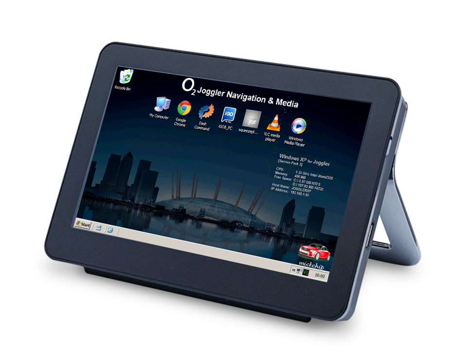

That looks really good, still in the middle of constructing mine, having it with a 32gb pata ssd, internal gps + wifi & Bluetooth.
On another note I have built another XP_NAV on virtualbox but can't get it to start on the joggler ( EFI or Seabios ) but it works on the viliv and the Samsung Q1 ultra.

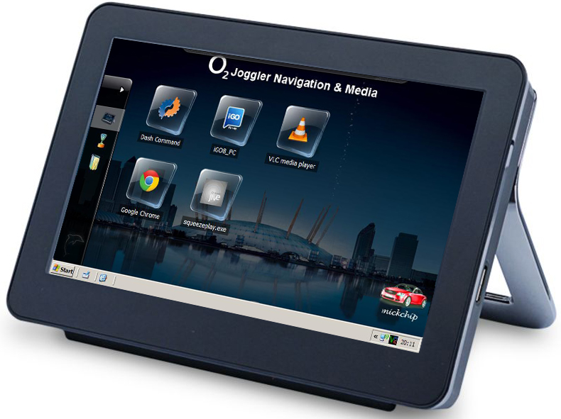

Coming soon, well maybe not so soon, will be on holiday from tomorrow for 23 nights.
Here's a taster of whats to come, based on Mevi's XP

mickchip wrote:Coming soon, well maybe not so soon, will be on holiday from tomorrow for 23 nights.
Have fun on your vacation!
I am looking forward to your new build - it looks great!!!
(I am trying to get an USB SSD, to see, if I can get this corebios build running....)
Ah - one question to your builds: You always include Squezeplay - what are you using it for in this car setup? Do you have LogitechMediaServer also running in your car?
Am I mising something?

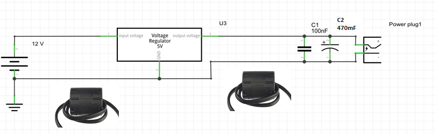

My powersupply is now 'engine-crank-save'!
I tried it around 20 times (stopping and starting the engine while the Joggler is powered up): No crashes anymore!
Adding the 0.47F 'Goldcap' did the trick.
See below a sketch on how my power supply is now wired up (the ferrite cores in teh 12V and 5 V line are still in, but I doubt that I need them:
All the best,
Heiner

Thanks for sharing that diagram , is there any logic to the capacitors ? or is it just the bigger the better ?
Also are your ferrite cores wrapped around the live , neutral or both ?
I ordered some mini fuses with live wires attatched as i dont want to tamper with the vehicle :-)

hawsey wrote:Thanks for sharing that diagram , is there any logic to the capacitors ? or is it just the bigger the better ?
They have arrived and look pretty good so will try soon and report back ....
For 12v to 5v i am using a multi volt selector cigarette lighter socket supply .
Reg. the caps: Bigger is always better :D
But also, you can calculate what you need:
C = I * t / U or t(time) = C * U / I
So I guestimated that I need to cover t = 0,5 sec of power outage when cranking. Also, I assumed the joggler needs I = 3 Amps @ U = 5 Volts (There are measurements in the wiki - also the official power supply is rated with 4 Amps). That brings you somewhere to C = 0,5F
(Note: I never could measure the actual drop - I even tried with an Arduino capturing the Voltage with a high sample rate. Maybe, because it happens so erratic)
Reg. the ferrite cores: Both the life and ground wire get looped around the core.
Then reg. your power supply: Make sure it can provide around 3 Amps. Otherwise, you will fry it or the Joggler sooner or later.
Good luck!!

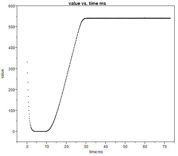

I think we will need some cap.
I finally managed to trace the voltage drop when cranking the engine!
It is so short that my initial Arduino setup did not catch it.
Now I changed the code to do some quicker sampling - and I catched it - see graph.
The voltage drops down to 0 Volts - even though I added 2000µF in the 12Volt line.
But: It only drops briefly and recoveres already after ~ 30msec!!
I used this web-page to calculate what we capacitance I need to cover these 30msecs:
http://wetec.vrok.de/rechner/cclad.htm
-> I need around 20.000µF to cover 2 Amps for ~50msecs.
-> I ordererd 2 x 22.000µF electrolyte caps (just to be save).
These will only arrive in 1 week.... I am really curious, if this will finally work.....
