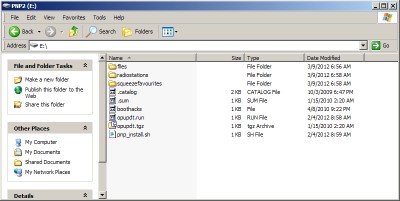

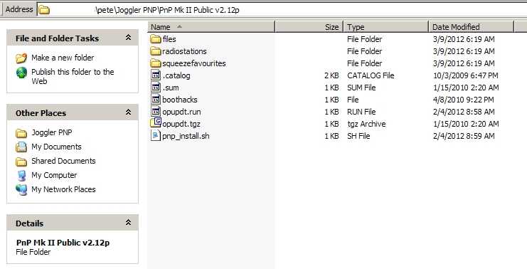

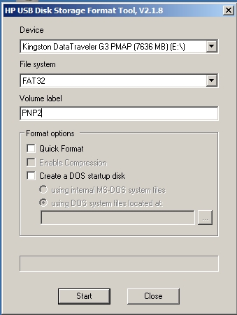

Re: PnP Mk II - Here it is!
So a different step by step. I've included the pictures. If you have copied the unzipped files over to the memory stick and do not see then then stop here and recheck your steps.
Phase I (an edit per say - will try this on another Joggler to test) - NOTE: If you are not familiar or have never done this be careful and note the disclaimers posted related to doing this to your Joggler.
1 - Reflash Joggler to original O2 OS such that you have a stock Joggler
http://birdslikewires.co.uk/articles/jogglerflash
2 - register Joggler
Phase II
1 - put your memory stick in your Wintel box USB port.
2 - format the stick using the "HP USB Disk Storage Format Tool" (see pics 1 & 2)
3 - Unzip the downloaded files to a temporary directory. I used 7 zip.
4 - validate initially that all of the files are in the temporary directory (look at pic #3)
5 - manually highlight all of the files and do a copy and paste over to the memory stick. (look at pic #4)
Stop here if you do not see the files on the memory stick.
Do you see the files?
6 - boot up the Joggler to the regular Joggler O2 OS
7 - put the memory stick in the Joggler. The LED (if you have one on the stick) should flash.
Stop here if it doesn't flash
8 - go to the Photos widget and hit the USB icon. The LED light will flash. You should see pictures of the icons / widgets on the memory stick.
Stop here if you don't see the photos on the memory stick.
9 - If you get this far then the Joggler is recognizing the USB stick with the files that you copied over.
I'm doing it here right now.
OK this is what I've done:
Reflashed the Joggler with the birdslikewires app
Rebooted the Joggler - native OS
Registered my name etc and set up wired and wireless connection
Formatted the memory stick (a Kingston DataTraveler G3 4GB) using the HP USB Disk Storage Format Tool v2.2.3 (screenshot 1)
Downloaded the PNP2 files into my Downloads folder
Unzipped using 7z into the root of the USB stick
Powered down the Joggler, inserted the stick, powered up
and .....
Maybe it was the HP format thing that did the trick (because everything else is the same as I've done half a million times already) but when it rebooted it came up with the white on black O2 logo rather than the native OS ..... so I think I'm getting somewhere!
Fingers crossed .... and thanks for the help so far!

No consolation needed ... it works!! Looks fab - just getting Spotify on there and i'll be a very happy bunny. Depending on how stable it is I might even pick up a second one to give to my mum - she really likes mine but up till now it's always been a bit flaky.
Really impressed with this new version so far - thanks for everyone's hard work!
Added .... had a play with it now, really seriously impressed, it's awesome!!
I don't think people are having problems with PnP2 as such, I think the problem is probably with their USB sticks, perhaps some with old boot partitions that haven't been formatted properly etc.offbeatdave wrote:I'm sorry to hear people are having problems!.
As chelseagirl mentions, when the stick is formatted properly, using the right tools, PnP2 installs without a hitch.
