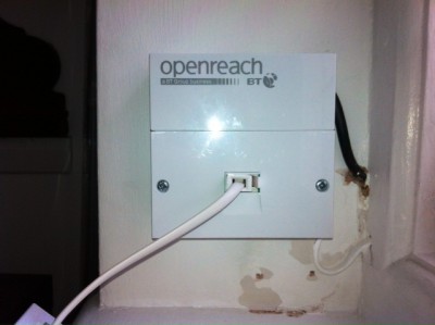

Hi Hawsey
Thanks for your advice. Here's the new internal master socket installed by BT a couple of days ago. Is it the one you mentioned? Router has been tested on all sockets (no change to speed) but I can't move router long term as the xbox is attached to it in another room.
Hopefully sky can sort it out and get us back up to our usual 5 meg. Which is still a bit rubbish really.
PS. He mucked up our paintwork!

Hopefully you get it sorted soon , so how does the cable get from the main socket to the Xbox ?
Moving the router will not change the speed unless the internal extensions are removed or filtered and the line is re set if your line is BT wholesale ( that's in places where you can't get the cheap sky deals )
Can the black cable coming in to the house not be moved to where the Xbox and router is ? That would be the best solution then with a SSFP your extensions would be filtered out .
Good luck .

hawsey wrote:so how does the cable get from the main socket to the Xbox ?
wired in extension lead.
hawsey wrote:Moving the router will not change the speed unless the internal extensions are removed or filtered and the line is re set if your line is BT wholesale ( that's in places where you can't get the cheap sky deals ).
Hmm. I tried the router in the main socket with all extensions and other phones removed but there was no resetting of the line... :?:
hawsey wrote:Can the black cable coming in to the house not be moved to where the Xbox and router is ? That would be the best solution then with a SSFP your extensions would be filtered out.
Not really as the xbox is housed in the middle of the house with no external walls.
Re: speed of your broadband?
Is it not wireless :-)
If you could wireless your Xbox and move the router to the main socket (with exyensions either filtered out or removed )then get a re set you will get your max possible speed like that :-)
