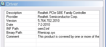

Here is the Realtek Diagnostic info Mevi.
Its really the HW IDs stuff that is important. Is your similiar between the two Jogglers?

I'll have a look for that app.pete_c wrote:You swapped out the EFI chip and it still didn't boot with Wintel?
There is a diagnostic Realtek application which tells you a bit more about the chipset on the Realtek.
I've been banging on about this problem joggler for ages, so no surprise I've left anyone lost!
Problem Joggler - NIC device does not start with an Error 10 in the device properties. Device has an exclamation mark against it. Reading up on this error on this Realtek chipset, seems to point to a BIOS update to cure it - hence looking in the EFI for a resolution.
Good Joggler - 1st one I bought, works fine, no NIC problems. It's the one I used for my build.
I've swapped chips and WLAN between Jogglers which made no difference whatsoever. The HW ID is the same on both Jogglers.
