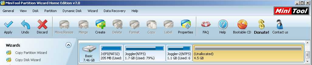

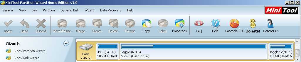

Via Windows try the MiniTool partition manager. I'm trying this right now on a G3 8 Gb memory stick.
You can download the MiniTool partition manager here:
http://www.partitionwizard.com/free-par ... nager.html
1 - copy the image to the 8Gb stick.
2 - Look at the USB stick with MiniTools partition manager; you will see it similiar to above picture.
2 - Expand the NTFS partition to the rest of the 8Gb stick.
2 - Exit out of mini tools and you should only see the FAT partition. Make sure all of the EFI stuff is there.
You can do the same with GParted in Linux.

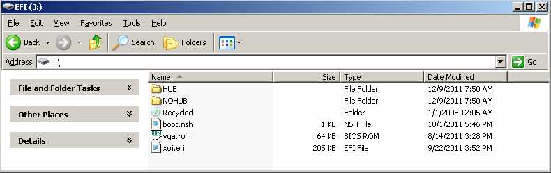

If it still doesn't boot, delete the fat partition and create a new one; then just copy all of the EFI files to it. I've attached a ZIP that has them all.
EFI.zip
(500.97 KiB) Downloaded 292 times
The 2nd partition must be an active primary ntfs partition in order to work. Also the 1st partition cannot be too small. The EFI bootloader is very particular. A disk cloning tool like Pete linked to is the best way to ensure the partitions copy across correctly. :)
