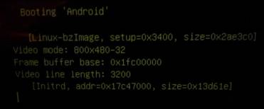

Unfortunately I couldn't get it to work. Just hangs on the following screen:
Any thoughts?
Re: ICS X86 Source Out!
Are you using a hub?

No - not using a hub. The joggler does have plug n pimp on it though (in case that makes any difference).
Does the stick you are using work with Buzz's images or the 1.2.3 android image?

The stick works for Buzz's images and the 1.2.3 android image.
hmmm so i used the hp utility to sort out my stick and format with fat32 and then the file i downloaded i extracted straight to the stick ...
When I get a moment, I'll check it on the other Jogglers and see if internal Flash makes a difference. I can re-flash the O2 Joggler that it wouldn't boot on and see if boots ICS afterwards.
If buzz's images work this should also. I would try redownloading both the files, first the 99mb file should be written to the disk and then the extracted easy package, merging folders if asked

Ok so unzip the "ICS_Joggler_4.0.3_Alpha.zip" file first, then the "Easy_to_use_package_Usbdisk(ICS).zip" file.
So this means the grub.cfg file that will be left on the USB stick will be the one from the "Easy_to_use_package_Usbdisk(ICS).zip" file, as that file is unzipped last. Is that correct?

OK, I finally got this to boot by doing the following:
- Formatted the USB stick using the HP format utility,
- Unzipped the "Easy_to_use_package_Usbdisk(ICS).zip" first,
- Then unzipped the "ICS_Joggler_4.0.3_Alpha.zip" file second, and over wrote the grub.cfg file.
This way, the grub.cfg file that ended up being on the USB disk was the one from the "ICS_Joggler_4.0.3_Alpha.zip" file.
Funnily enough, the joggler will only boot off the USB stick on every second reboot. Weird....
Anyway, I just wanted to say a big thanks to everyone for helping me to get this working.

Pretty sure you should be doing the 'Alpha' followed by the 'Easy' zip. The grub from the 'Easy' refers to the img files for the sdcard etc.
That is what I did, from the mijuu instructions. Do you have an sdcard showing in the storage section on ICS?

There was no SD card showing in the storage section. I'll try again using the order you mentioned, and see if an sdcard shows up .
