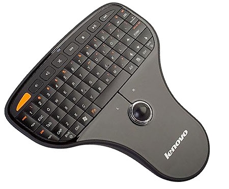

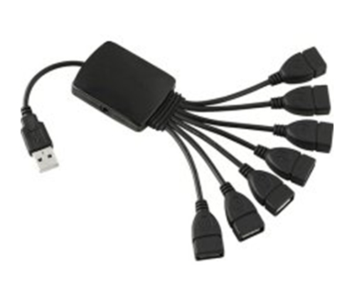

I've gone to utilizing the attached picture style USB Hub. It is 7 ports powered or unpowered. It seems to be OK. After initial configurations and boots and reboots I pretty much just take it to VNC/touch with just the memory stick plugged into the side port. It'll boot faster without a hub for me. I also lately just utilize the small Lenova wireless keyboard. Its not a convential keyboard though; but a really small footprint.
Noticed too that there is different behavior relating to using a memory stick, ZIF Drive or USB SSD stick whether you are using the internal versus the external USB port; with the booting preference going to the external port. This does allow though for the ability to change the internal USB device by booting with the external device allowing for some flexiblity.
It seems to work best with the first port. It is today's "hub du jour"; and have utilized a variety of 4 port and 7 port hubs; powered and non powered.
I zipped and uploaded a base do all EFI which I keep only the most basic files in two directories called HUB or NOHUB. First boot is always just the HUB directory. You can just plug the memory stick into your computer and change what EFI files it used to boot. I attached the basic EFI directory with the two subdirectorys. Works for me.
