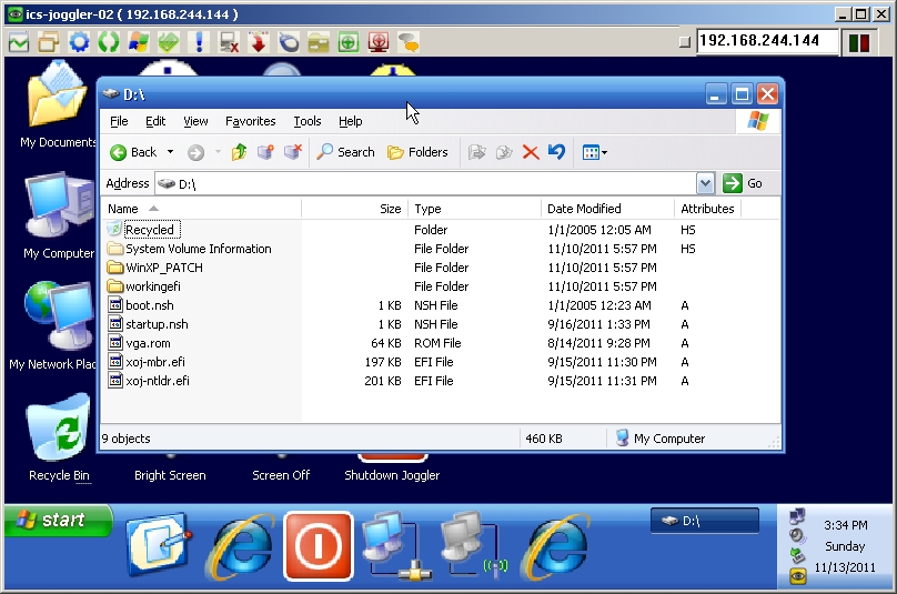

OK so I copied the three EFI files from the oldest running Joggler to your last posted image EFI partition.
1 - Removed the NIC cable and did a cold boot. Booted up fine - no change in time to live OS.
2 - Next a warm boot. It worked! Very interesting. I only saw the O2 screen for a second or two then loaded OS. Fast boot. Went right to XP.
3 - Next I shut it down and plugged it into the 7 port hub with a keyboard dongle; just picked a port at random. Error NTDETECT failed. Moved the stick to another port. Same error. Removed the keyboard dongle. Tried again. Same error.
4 - Plugged the NIC cable in - didn't lock up first time; went right to the network.
I don't understand anymore; getting EFI confused now.
So no go for me with the 7 port hub. The difference though is that I've only used the Hub with memory sticks and not the SSD USB drive and the "in production" USB SSD its on the inside USB port.
For now will leave these three files in the EFI directory.
Here are the three files anyways; see if they are different for you; check out the warm boot thing.

Those three xoj efi files are awesome if you do not need to use a hub, but will fail on a hub, for hub use i suggest using xojntldr.efi, xojmbr.efi boot.nsh, and startup.nsh. i acn post them from one of my earlier builds if you like?
Re: RELEASE - Windows XP Professional SP3
Oh and dont forget vga.rom either lol

Those old EFI files work as on yours, Pete. Quicker to run through the EFI section and I get warm boots just fine. Seems that there is something that stays resident in memory while the power is still connected as switching the EFI files back to the newer ones before rebooting also resulted in a successful warm boot. After a cold boot, that ability was lost.
The NIC still doesn't work on the problem Joggler.
I'll head over to Eric's page tomorrow to see if there are other newer or older EFIs that I can try.
