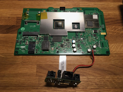

monkeydogcat wrote: Wed May 13, 2020 10:01 pm I said it before, but I'll say it again, it's such a shame about the graphics chip in the Joggler.
It's a brilliant little box for doing this but it's only possible because of being able to utilise the openGL and video decoding capability of the graphics chip, which is of course impossible with any modern Linux distro. I really hope I can keep it working for what I use it for for many years to come.
The Ubuntu Bionic image does support OpenGL (at about half the performance of the EMGD driver due to it not having the hardware acceleration) using the kernel driver, but not VA-API. Last time I tried running:
sudo of-install xserver
sudo apt install xubuntu-desktop
Landed me at the login screen.
But yes, it's a real shame about acceleration. My OpenFrame 2 currently looks like this:
So I can fit a BCM70015 hardware video decoder to that little mini-PCIe slot to see if my build of Plex Media Player is of any use. It's fine for audio, but the overhead of the UI makes video pretty useless, even with server transcoding.
