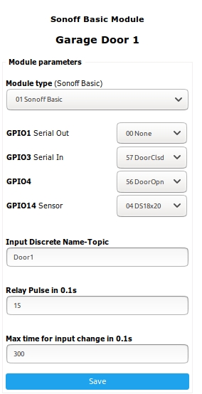

Here slowly (baby steps) utilizing MQTT for automation. It is a bit similiar to using xAP or xPL from years ago.
Historically not one to automate using WiFi. With Mosquitto and WiFi and updatable ESPXXX devices you can do all sorts of stuff.
Here is an example.
My current garage door automation is hardwired to the security panel. IE: PIR, Open door, close door and button.
A test here is using an el cheapo SonOff Wifi Basic module modified for use with Mosquitto. Multifunctional and a $4.00 USD device which:
1 - reads the temperature and or humidity in the garage - talking Mosquitto
2 - has wired open and closed door reed sensors (2)
3 - has momentary button to open or close garage door
4 - you can add more sensors to it if you want.
