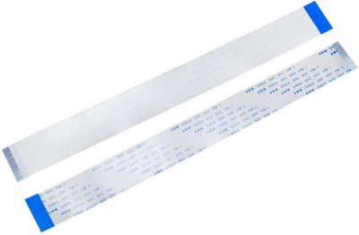

2, the zif cable and socket is 0.5mm size, right?
It is a standard 40 pin zif cable and the ends were flipped that I am using.

what does flipped mean?
The exposed end of the ZIF cable is opposite from end to end.
Just noticed that the cables are here on Amazon and they are the correct length.
Here is a link to Amazon for the cables if you can get to it.
I guess they are also called Type B ZIF cables.
Xiaoyztan 40 Pin Flexible Flat Ribbon Cable 0.5mm Pitch FFC FPC for LCD TV Car Audio DVD Player Laptop (200mm Length, Pack of 20Pcs)
https://www.amazon.com/Yootop-Flexible- ... _ci_mcx_mi

Pete, know I know what flipped means. On this case, just two ends have conductive pins on opposite sides. It is easy to have in China since all made here. hahaha......
