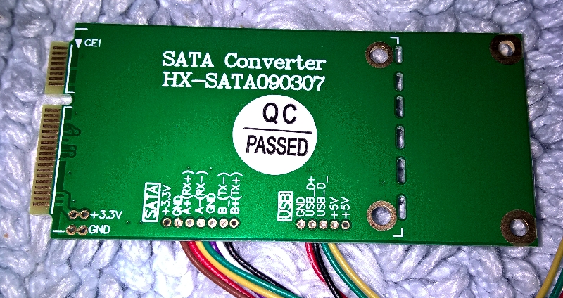

OK so looked at one OF that I had configured with Squeezeplayer and redoing it.
Got the PCie to SATA/USB card from Russia yesterday. First time I have ever ordered anything from Russia.
Checked out the mini PCiE to SATA card. It has no chips on it and just wires to connect to a SATA drive. It must be an mSATA card?? Can you connect a SATA drive directly to a mini PCiE port? Way back did try an mSATA card which did not work.
Here is a picture of the two sides of the board. It has a SATA and USB connector on it.
hxxp://www.soarland.com/USB_SATA_to_mini_PCIe_ ... t-502.html
  • No need driver, suitable for any small size USB device into laptop, it can be used for USB Card Reader for micorSD/M2, USB Disk driver, USB WIFI or wireless card
    Slot type: mini pci-e
    Expansion: 5-PIN USB 2.0 data
    Fastest read and write speed: 30M/S
    Support full-height or half-height cards
    It only can support the mini pcie slot with normal USB deification
    Pls make sure the MINI PCIE on your motherboard supports USB signals before purchase
Is this an mSATA card?
I still have the Crystal HD card which did work originally with very first KODI (XBMC) Ubuntu 14.X build for the OF2 as I posted the results here while testing it on my test and open OF2 motherboard. I did post my results here on the forum some place.
I do have a test OF2 motherboard which has been removed from case to tinker with. It is a PITA to use these days as I was using painters tape to keep the touchscreen attached to the motherboard. This one has an aux USB port soldered to the camera wires on top of the motherboard.
