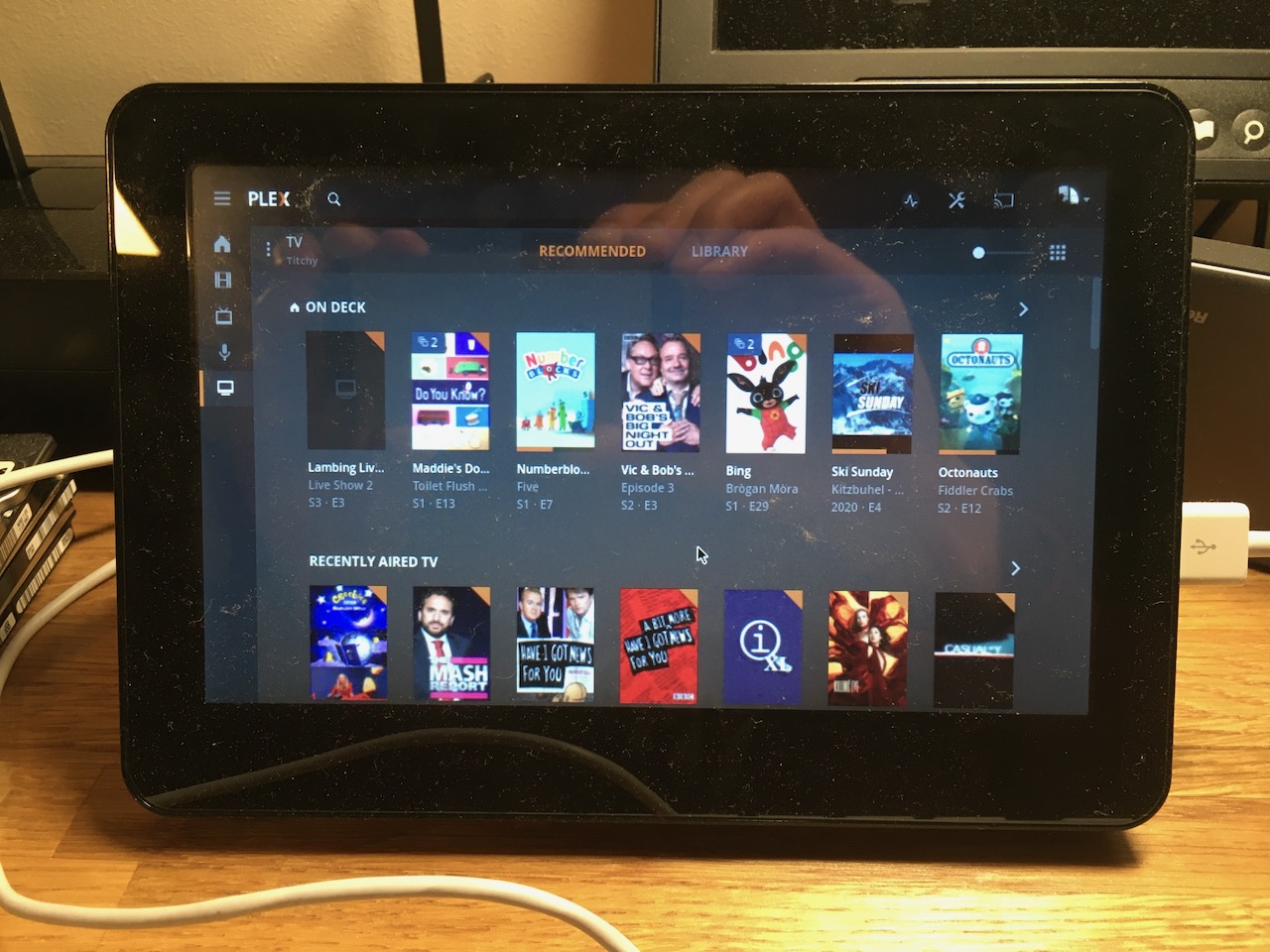

Tried this out just for the sake of it.
It neither works terribly well (it's the web UI) nor does it fit on the internal memory, but it's kinda fun. If there were a 32-bit build of Plex Media Player that might be a different matter, but nobody has made one yet. I do use Plex and with the server handling transcoding it might decent. The Joggler can definitely downscale 720p to 480p and play it smoothly with CPU power alone, just so long as it's not supporting a whole bunch o' web browser at the same time.

How did you manage to get the streaming / chromecast icon to be visible? I can't see it in my setup just a TV icon or exit full-screen.
I would mainly use the plex to stream to the chromecast on the TV, else I have not yet found a good use-case.
Thank you
Re: Install Plex in Joggler main Memory
Sorry, I have absolutely no idea - I can't remember! I was surprised that it worked at all. :lol:
