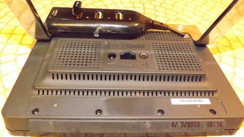

Another option is the addition of a small USB hub to the back of the Joggler using the motherboard pins for USB 2.0 as documented on the Joggler Wiki.

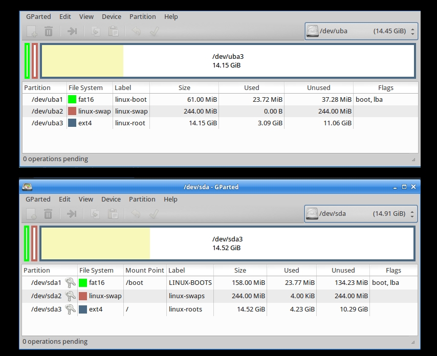

Basically here just wrote Buzz's Ubuntu latest desktop image to a PATA SSD ZIF drive using a small ZIF to mini USB card.
Expanded the image to the size of the SSD.
Used GParted to rename the partitions to linux-boots, linux-swap2 and linux-roots
Edited the /boot/grub.cfg file like so:
loadfont /unicode.pf2
terminal_output gfxterm
set timeout=5
menuentry "Xubuntu 14.04 LTS (Trusty) - 3.2.84joggler1" {
linux /vmlinuz-3.2.84joggler1 root=LABEL=linux-roots ro quiet splash
initrd /initrd.img-3.2.84joggler1
Edit the /etc/fstab file like so:
# /etc/fstab: static file system information.
# Use 'blkid -o value -s UUID' to print the universally unique identifier
# for a device; this may be used with UUID= as a more robust way to name
# devices that works even if disks are added and removed. See fstab(5).
# <file system> <mount point> <type> <options> <dump> <pass>
proc /proc proc nodev,noexec,nosuid 0 0
LABEL=linux-roots / ext4 errors=remount-ro,noatime 0 1
LABEL=LINUX-BOOTS /boot vfat defaults 0 0
LABEL=linux-swaps none swap sw 0 0
tmpfs /tmp tmpfs defaults 0 0
You can keep the entire working partition to the PATA SSD card. Here used a 16Gb USB stick for my /home directory stuff. Easy to do this by:
1 - create a new ext4 partition on the USB stick using Gparted from the Joggler Ubuntu desktop
2 - mount a new home directory locally on the SSD IE: say /media/home
3 - rsync /home to /media/home IE: sudo rsync -aXS --exclude='/*/.gvfs' /home/. /media/home/.
4 - edit your /etc/fstab file to include or use the new home partition
IE: /dev/uba3 /home ext4 defaults 0 2

One other issue that I have seen in the last few years is that the barrel connector / NIC / Audio board ports sink in to the Joggler. This can cause an intermittent power connection to the Joggler. This is because the board is mounted with hot melt glue. The easy fix is just to heat up the glue until it melts a bit while holding the board in place. To get to the combo board you have to remove or move the motherboard over a bit. I used a BBQ grill gas lighter with a stalk to heat up the hot melt glue just for a few seconds such that I do not melt the plastic around the board.
