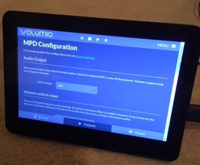

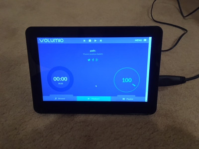

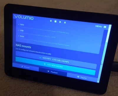

I've attached some photos of a neutered volumio at least running on the joggler. Maybe me or someone else could pick it up later. There are volumio plugins for LMS and squeezelite, but I didn't test those.
I installed the Xubuntu 14.04 image and then followed bits of the guide: installed a load of Volumio dependencies, alsa-tool, mpd, then pulled down the Volumio GUI from github.
The GUI is there but a whole raft of permissions issues means it doesn't do much. I can at least add a SAMBA share (which persists through reboots). It recognises the sound device as "MID", which sounds
"aplay -l" lists the available devices as below:
card 0: MID [HDA Intel MID], device 0: STAC92xx Analog [STAC92xx Analog]
Subdevices: 1/1
Subdevice #0: subdevice #0
card 0: MID [HDA Intel MID], device 1: STAC92xx Digital [STAC92xx Digital]
Subdevices: 1/1
However, whatever permissions issues exist mean that MPD isn't indexing files and probably a load of other issues too. I can't add files over the network so didn't get it to play anything. Time constraints mean this little experiment has come to an end for me for the time being.
