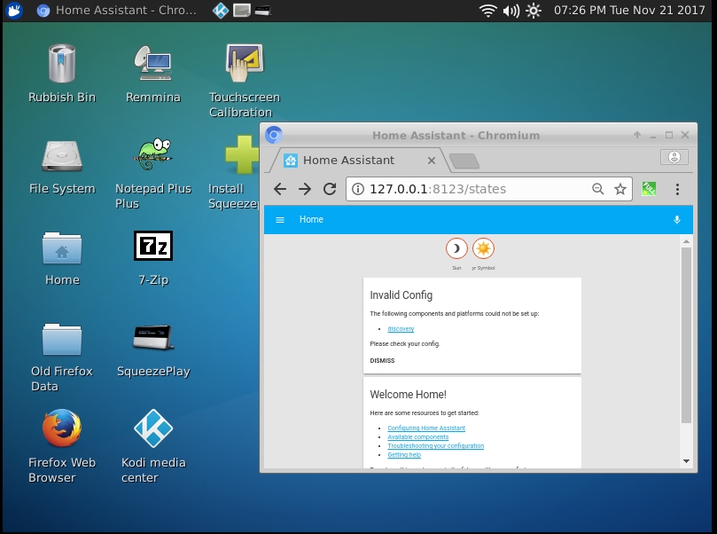

Re: Homeassistant
Test installed it on my Joggler / SSD.
Local desktop / RDP desktop worked fine with Chrome and Firefox.
Didn't really do anything special.

Pete,
Thanks.
Just installed FF and yes, it works fine. However still doesn't work for me in Chrome...
Forgot how hard it is to scroll up and down the screen using the touch interface. Don't think it's going to pass the wife test. Perhaps I will use some cheap amazon tablets as other on the HA forums have done.
Very much appreciate your help - and interesting to see it installed on the joggler!
T
