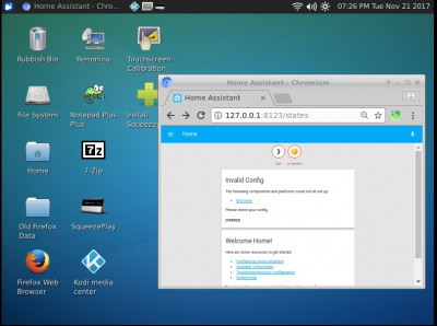

Test installed it on my Joggler / SSD.
Local desktop / RDP desktop worked fine with Chrome and Firefox.
Didn't really do anything special.

Thinking that Chrome is a bit fatter than Firefox these days.
It is difficult to scroll up and down a screen here. I cheated above using a wireless Logitech mouse.
Touch works better in Windows 10, Android, iOS and newer versions of Ubuntu.
