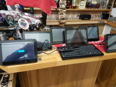

Just got around to updating my jogglers to pnpIII v3.6, two already in service, the very last one would not flash.
It took the latest firmware and I restarted it, then tried pnpIII after that nothing, even tried using unr to make an image of one of the working jogglers and DDing it to the none working still nothing, looks like that one is calling for the PATA mod.
By the way thanks for the update Craig, makes a big difference to the functionality.

Have you tried doing a regular Ubuntu boot and a repair of the 1Gb EMMC (not sure if you can do this anyways)?
BTW relating to the Openpeak 2 larger device it does have traces for a microSD card. I never got around to getting only test working on the Openpeak 2 open motherboard. This would be an easier small footprint easy fit inside of the case solution.

Yes I have tried doing a repair, I have dd'd a complete image to the mmc and I can mount the partitions in ubuntu and see all the files but it will not boot.
I have flashed Squeezeplay OS to this one and it is working ok so I'm leaving it at that.

@mickchip...try a swap on the the boot rom, maybe too a hot-swap, and then a rewrite of the rom from booting rom.
