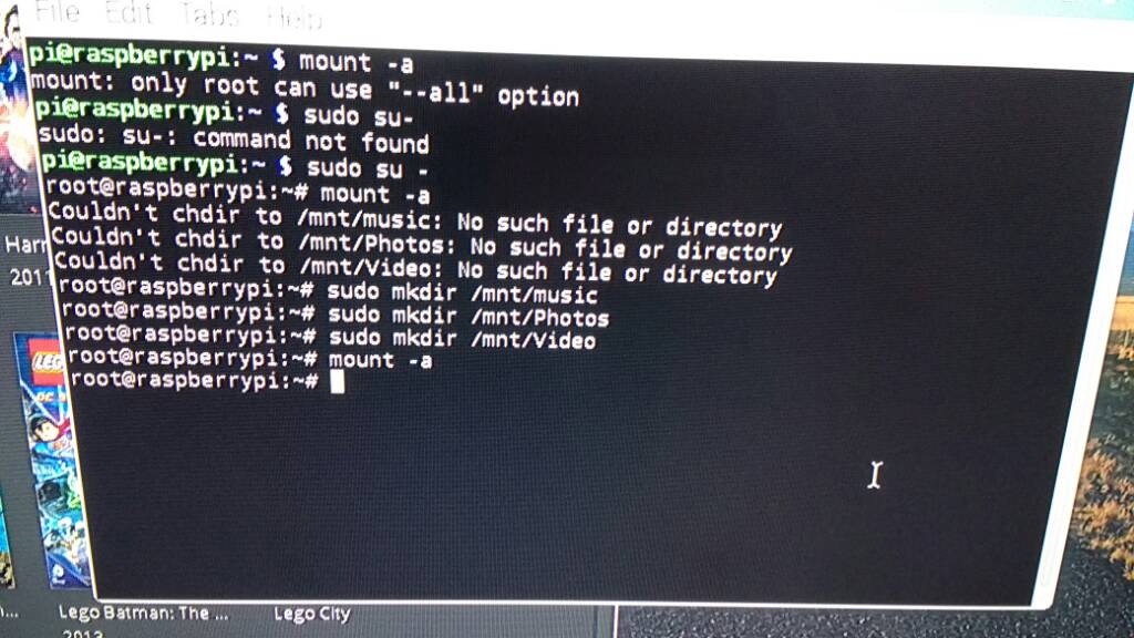

I logged in as root then
Changed the Fstab as in the photo above then in a terminal
sudo su -
mount -a
sudo mkdir /mnt/Video
mount -a
That's all I did and then I re booted , the Plex server picked up the few files I had in the folder no problem , I then tried to download some episodes of a TV show and the first two scanned no problem then I tried 3 more and it broke , now the drive looks like it's not mounted any more ,

Anyway I just tried the above code again and it has mounted and scanning again .
Maybe I have missed some code out to get it to stay mounted .
Thanks for the help :-)

Thanks I've just re read your post so it looks like it ( my network HDD ) will un mount on a re boot unless I do the trickery you explained :-(
