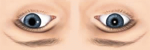

I do all interaction with the Joggler over SSH, unless it requires actually touching the screen.
joggler@joggler:~$ export ICEAUTHORITY=/home/joggler/.ICEauthority
joggler@joggler:~$ export DISPLAY=:0
joggler@joggler:~$ xeyes

root@joggler:~# xeyes
No protocol specified
Error: Can't open display: :0
Logged out as root and logged in as Joggler.
j
Just get a blinking cursor here. I am guessing that it is working??
