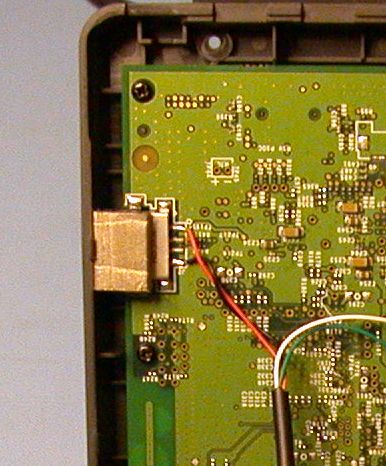

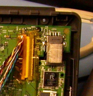

Dismantling the Joggler once more, this time on the kitchen worktop where the light is very bright, I noticed something I hadn't spotted before... a bit of the case at the back of this Joggler is deformed - it's obviously been very hot at some point. Hopefully you can see the attached pics:
Inside the Joggler, the nearest component to the deformed bit of case is this large chip that I've drawn a yellow box around (it's next to the EFI chip):
I never noticed it before, but I'm 99.9% sure I didn't do it in the last 24 hours, as there's been no smoke or smells whilst I've been tinkering. Maybe this mini-meltdown is what spontaneously killed my Joggler in the first place? Maybe I was lucky the house didn't burn down. Do you gents know what that component is?

The component you've highlighted h5007nl looks like it has a collection of transformers inside and it appears that it can get hot, from the datasheet.
eu.mouser.com/ProductDetail/Pulse/H5007 ... sXDg%3D%3D
productfinder.pulseeng.com/products/dat ... /HC500.pdf
But if a component gets hot enough to damage the case I would have expected to see some effect on the component and maybe in the surrounding area - say the PCB is a slightly different colour. Also, if you smell it really close you can pick up a certain scent.
From the pic you have shown, I don't see any sort of damage. I guess you could get some IC testing equipment and test that chip out. I've not seen anything like this before.
I think the chip has something to do with the network. Just wondering if you've used power over ethernet ?
