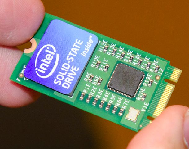

My last computer build I went with an m.2 sata for a hard drive. It is tiny. I am amazed. PC has been on 24/7 now for many months and running well. I noticed now too you can purchase an m2 to USB card. This would fit fine inside of the Joggler.
