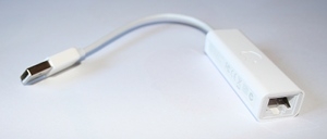

I think mine is a real one and looks like
It looks like the joggler sees it, but nothing on ifconfig so presumably the correct asix module is not loading.
I'll boot up in ubuntu and see if if is configurable
joggler@openframe:~$ lsusb
Bus 001 Device 002: ID 148f:2770 Ralink Technology, Corp. RT2770 Wireless Adapte r
Bus 001 Device 005: ID 0b95:7720 ASIX Electronics Corp. AX88772
