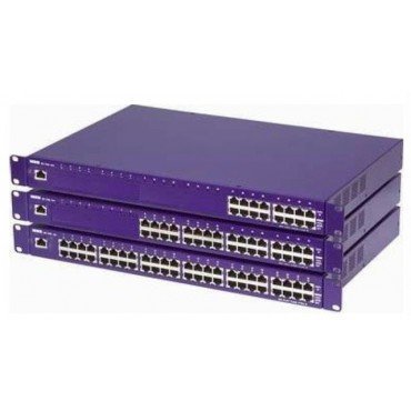

Here I have been using a few the Jogglers (up to 20) as automation consoles. That said they are on 24/7 and managed by the mothership.
These are POE connected using TP-Link POE splitters providing the 5VDC necessary for the Joggler.
I am using a managed POE mid stream injector from a company named Tycon.
The automation mothership shuts off the screens at night.
