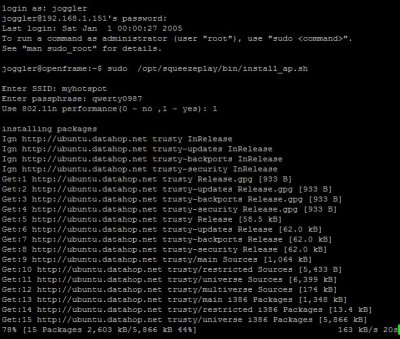

jogglerhase wrote:
palindrom wrote:......
This bash installation script will automatic install and configure your AP
You only have to enter your SSID, password and your speed decision (802.11g/802.11n)
The attachment install_ap.zip is no longer available
Hi Palindrom;
I am using the std. internal Joggler WLAN USB Stick. Everything works fine - but only when using wireless g mode.
If I use your script to switch to n mode, the AP function does not work, i.e. I can not access my network via the joggler, only through my std AP.
Any ideas why that is & how to fix it?
Heiner
I tried the attaches script with "n" option direct after clean reflash. Working. But I needed to power off the joggler.
Pleas try the attaches script (channel 1) please.
EDIT:
We need to wait for the bridge to be ready before we start hostapd
The attaches script will change /etc/network/interfaces accordingly
sudo mv /etc/init.d/hostapd /
sudo /opt/squeezeplay/bin/install_ap.sh
install_ap.zip
Updated script
(2.66 KiB) Downloaded 489 times

jogglerhase
Posts: 174
Re: SqueezePlay OS (Version 3) for OpenFrame
Post by jogglerhase »
This bash installation script will automatic install and configure your AP.....
EDIT:
sudo /opt/squeezeplay/bin/install_ap.sh....
Hi Palindrom;
I tried this new skript - including the prior mv.
And both befor and after your update of the post - no luck.
If I try n mode, no wireless comes up at all. (Even with shutdown and power off)
Going back to g mode fixes it.
Would still be great, if you could get n mode working...
I am just puzzeled, why it works for you??
Heiner
jogglerhase
Posts: 174
palindrom wrote:.....I tried the attached script with "n" option direct after clean reflash. Working. But I needed to power off the joggler.
Please try the attaches script (channel 1) please.
EDIT:
Hi Palindrom;
I tried this now also on a fresh install (on my backup Joggler)
On this one, I do not get any option (g or n) working at all...
Can you pls confirm the steps needed again?
sudo apt-get -y update
sudo apt-get -y install hostapd
sudo apt-get -y install bridge-utils

If you have a new installed joggler you only need to copy the script to your joggler
recommended: /opt/squeezeplay/bin/install_ap.sh
or sudo nano /opt/squeezeplay/bin/install_ap.sh
and copy paste the script below...
then execute it
sudo chmod 755 /opt/squeezeplay/bin/install_ap.sh
it should ask you first for the parameters and then to enter the parameters ant downloading all needed modules.
PuTTY
PuTTY
sudo reboot

Tested with my OPEN PEAK joggler a minute ago.
hotspot
hotspot
