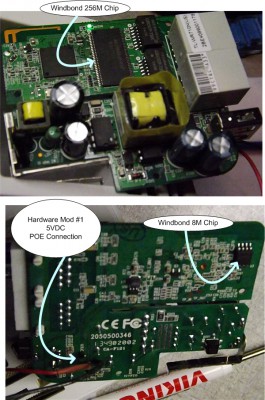

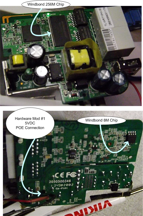

Goofing around here with a little microrouter in an attempt to do a bit more with it.
Microrouter: TP-Link TL-WR710 V1.0
I picked it up at Amazon dot come for some $19.95 USD. Looks like a first generation one and that is good relating to what it is I want to do with it.
From the OpenWRT page:
This device has a similar form factor as the TL-WR800N. It has the Atheros AR9331 chipset and two Ethernet ports. Another similar device is the TL-WR703N.
Version sold in Switzerland, Poland, Turkey & Austria - TL-WR710N(EU) has 8MB flash chip and 32MB ram.
The International/Chinese Version has a 2MB flash chip. Good news is that you can replace 2MB flash chip with bigger one and then you can run OpenWrt on this device.
Mine appears to have a 256mb RAM chip and a 8Mb flash chip in it although I can only see 32Mb right now.
First hardware modification was to put a 5VDC power input cable to it. Amazing little device. Goals are:
1 - Serial connection add
2 - 3G/4G add
3 - Wireless mods
Easy firmware flash via the original TP-Link GUI
BusyBox v1.19.4 (2013-12-14 13:44:40 PST) built-in shell (ash)
Enter 'help' for a list of built-in commands.
_______ ________ __
| |.-----.-----.-----.| | | |.----.| |_
| - || _ | -__| || | | || _|| _|
|_______|| __|_____|__|__||________||__| |____|
|__| W I R E L E S S F R E E D O M
BARRIER BREAKER (Bleeding Edge, r39076)
* 1/2 oz Galliano Pour all ingredients into
* 4 oz cold Coffee an irish coffee mug filled
* 1 1/2 oz Dark Rum with crushed ice. Stir.
* 2 tsp. Creme de Cacao
root@ICS-TP-Link-MR:~# date
Fri May 30 08:37:12 CDT 2014
Testing right now utilizing a POE injector and converting power to 5VDC. I want to put device inside of my alarm panel and utilize the 12VDC built into the panel (with battery).
Notice the pictures above show no markings relating to MFG of board.
