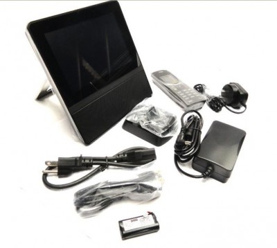

Hi guys.. Im trying to install Squeezeplay os on my 7" branded Telio Touch. This is just what im after a smal unit that can stram music from my Nas
The modelnumber is opof2b2110
I have tried to flash the device and its failing. I did manage to boot Linux of a usb stick. but would like to use the internal storage. I have tried flashing Openframe 1 and it failed, Tried Openframe 2, that seemed to flash but got an error message about not enough free space on target.
So you gurus out there.. Wtf am I doing wrong.

Re: SqueezePlay for Joggler (Native, Ubuntu & sqpOS)
Could you post a picture of the device? Perhaps it's a variant we've not seen before...parrafin23 wrote:I have tried to flash the device and its failing. I did manage to boot Linux of a usb stick. but would like to use the internal storage. I have tried flashing Openframe 1 and it failed, Tried Openframe 2, that seemed to flash but got an error message about not enough free space on target.
This is one of the models that I have:I have tried to flash the device and its failing. I did manage to boot Linux of a usb stick. but would like to use the internal storage. I have tried flashing Openframe 1 and it failed, Tried Openframe 2, that seemed to flash but got an error message about not enough free space on target.
OPOF2B2110
It has an Ayava OS. It has a 2 Gb MMC and a 1Mb soldered flash chip on it. The second similiar model I have is totally modded and appears to have been an O2 "test" box as internally the board has stuff removed from it and it has a socketed boot flash and it marked O2.
You have to be careful with it because the 1Mb flash chip is soldered in place.
That said I did get XBMC running on the 2Gb MMC and it worked fine but filled up right away.
Personally before playing with it some I would boot up into one of Buzz's Ubuntu images and have a look at the MMC and boot 1Mb pieces.
heya guys.. The pic that pere shows is the one I have.. Heres the backside of it :
I have now managed to wipe the os that was on the thing, and stuck in bootlader screen.. it says TELIO on the screen, if i put usb memstick with linux on it, it boots to it. (thank god, or who ever)
and i cant open the bugger, so i can solder in some hardware if needed..
Is this the one you guys are talking about?
Mr.P
Mr.P
