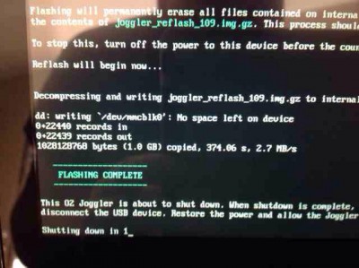

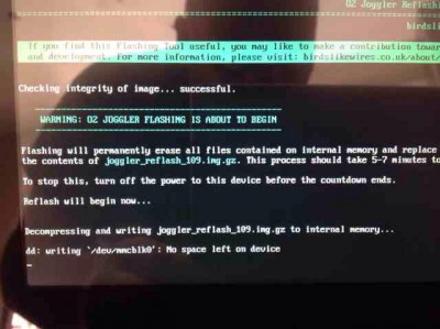

Hello again guys ... got another joggler to set up for a friend but it is the first one I have come across that is refusing to be re flashed ... it was bought fairly cheap as it wouldn't boot past the open peak logo at switch on
the re flash tool does not boot every time but when it does it seems to run through normally then displays 'no more room on device' before shutting down
any ideas? .... have not tried ext img on internal usb yet
Re: SqueezePlay OS (Version 2) for OpenFrame
I would guess that the internal memory is toast. The best plan would probably be to boot Squeezeplay OS from a USB stick instead.

Wee update .... successfully re flashed with latest open peak image which must have corrected any partitioning problems .... now successfully running SqP OS on internal memory and also boots to ext image on usb when required ....... result!
yup, 'never bin a joggler' lol
palindrom
Posts: 67
Joined: Mon Jan 27, 2014 4:14 pm
Post by palindrom »
roughlychiron wrote:Wee update .... successfully re flashed with latest open peak image which must have corrected any partitioning problems .... now successfully running SqP OS on internal memory and also boots to ext image on usb when required ....... result!
You can force the reflash tool to repartition:
Pop the USB key back into your computer and create a file in the reflash directory called repart. This will tell the script to recreate all of the partitions, even if it believes that it doesn’t need to be done. Eject the stick and use it to boot your Joggler again.

The boot stick is fat partitioned if I recall. Nothing much special about using it in windows that I remember.
The above said I have mostly only played with the MMC paritions in Linux.
If you feel like tinkering the motherboard has SD card traces, ZIF PATA port stuff and a mini pcie slot which would give you a bit better than using the USB port. The USB port did seem a bit faster though for whatever reasons than the O2 Joggler even though it was just USB 2.0. Maybe it was that the build was different?
