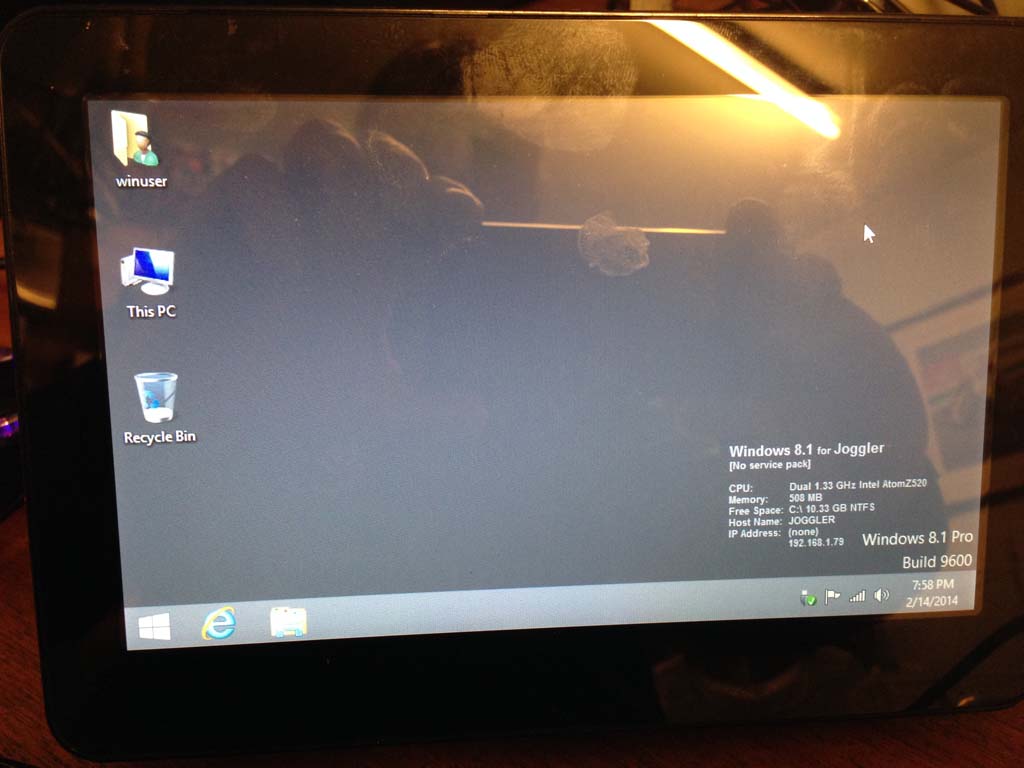

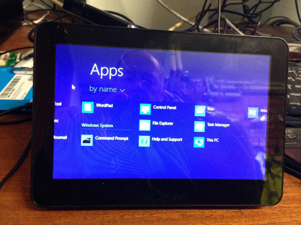

Installed a lite version of 8.1,used winreducer. Audio, wifi & Ethernet working
just a pity touch is only a pointer and we can't use downscaling

Is this using the EFI boot on an O2 Joggler?
What's windows doing with the MAC address on the built in NIC?
Is it running off of a USB stick or a ZIF SSD?

This one is using a 16GB SSD usb stick in the internal port, another I have is using the pata port WITH 16GB SSD.
Both are using coreboot & seabios

So you are using the originally posted coreboot/seabios with no mods to it?
How is the speed comparing it to the XP build?
On the XP builds (have a few doing TTS stuff) I just went to an Asix chipped USB connected NIC which is glued to the back of the Joggler and tapping an extra USB port inside.
What realtek NIC drivers are you using for this build?
How much space are you using for the OS?

This is really a minor issue compared to audio and network working.pity touch is only a pointer and we can't use downscaling

yep, coreboot & seabios v0.6. Ethernet uses 8.1s own driver, wifi & audio are from the Mevi's XP. Speed is OK but I havn't tested much software as yet.
I have 10GB free ot of 14.9GB
