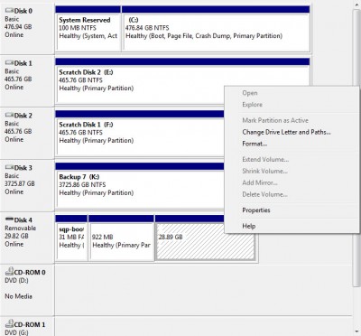

As a long time SB fan, I have just discovered the wonders of the Joggler for this purpose.
I would like to do exactly what you're discussing here, although with a 128GB USB stick a HDD should not be necessary.
I installed spOS to my "test" stick, and get everything working fine using my NAS LMS.
I then took the stick out and put it in my windows 7 PC, where I see it with 31MB boot partition and 922MB primary.
however I cannot create a partition on the unallocated space..
any ideas?
any ideas?

Re: My cunning plan with Squeezeplay OS

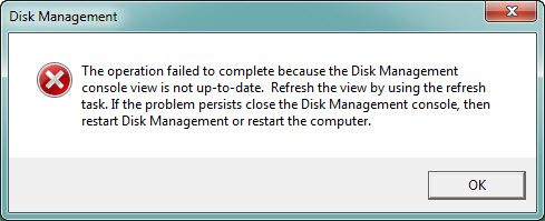

Hi, I formatted this unallocated space using GParted, and i get something that looks more positive.
However when I select change drive letters (or format) I get this:
Smells like something Windowsy to me. You could try using the GPartEd Live CD?wcndave wrote:However when I select change drive letters (or format) I get this:
Exactly where I went next. I wiped the entire stick with Gparted, and made it a FAT 32, then installed sqOS using disk imager and no luck. exactly the same. I will try to do the same thing but create 2 volumes using gparted. then install the OS to only one of them.
