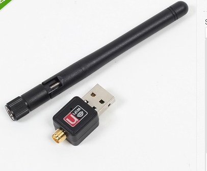

Does it matter which antenna goes to which side on the wifi stick? I suppose not?

I offered up a speaker and fitted the DAC there. Also used the space to put in an usb-cable.
I tested with wifi because I didn't have an ethernet cable which was long enough.. Tonight the testing goes on.
Can't i just measure via the usbport without cutting wires again?

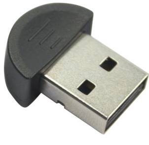

1 - wireless USB device? (personally I would go with a combo micro USB N and bluetooth USB device) instead of stock USB WLAN device)

Plans now changed because of non-working modifications so I tested a hub which was fitted to internal port. In the hub I put the wifi card on which I soldered a plug again to test, all works again. It only seems I have to disconnect the hub once I power up. Else it hangs at O2 logo.
But now I'm not sure of 1 thing: the hub is fitted on a 1,5m USB cable (for a reason). The DAC will be connected to the hub. Will the length of the USB cable effect the sound quality?? Should I keep the USB as short as possible?

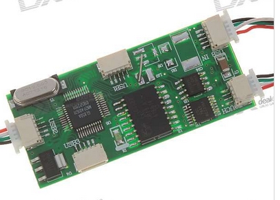

One of my hardware mods I fitted a USB female adaptor to the inside USB port and tacked it to the back of the Joggler.
That said for all of my experimenting I have been using 22 or thinner guage wire. Recently I refitted / replaced the Asix clone USB NIC cards with real Asix USB NICs. These are built totally different. Extra two wires for grounding the USB ports.
You can purchase a tiny barebones (no case) hub on ebay which is what I tested with. It does fit inside of the Joggler where the WLAN card was. That said I don't think it will be an issue using plan old wires (4) for the USB connections.
I would also fit a tiny keyboard/mouse wireless USB thing somewhere. I use two types. One is the little Lenova remote combo. Its a bit difficult to utilize. The other is a fully sized keyboard with a mouse pad which is much easier to use. Knowing that you want to stick with wireless then even easier would be to use one of those new combo mini wireless bluetooth sticks and look for one with a little sma connector on it then connect an external WLAN antenna on the back of it. These also are on ebay for some $3 each.
Tiny USB board.
