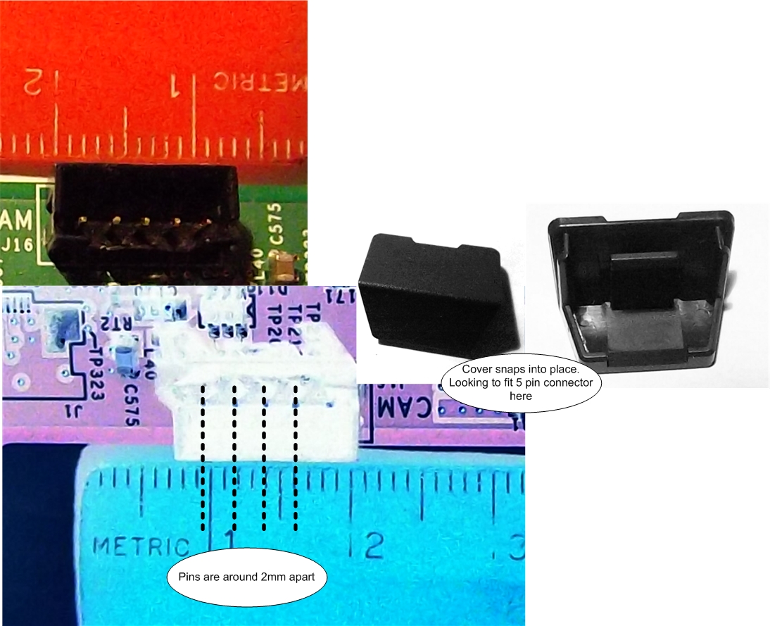

I have found the connectors needed for the Openframe 2.0 top USB to webcam setup.
This post will list the parts needed and sources. Total cost should be less than $20 USD.
Attached is one picture of one tiny USB cam. There are a few in internetlandia. First one will be a hack job with the USB connector to Openframe 2.0 already assembled such that you can fit the webcam on the top connector of the Openframe 2.0 device.
Found the right connector for the top of the Openpeak device.
10pcs 1 x 40pin 2mm Female Single Row Breakaway Pin header for Arduino DIY New
