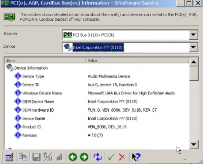

On the Openframe 2 devices I did find xp drivers for the BCM combo bluetooth and wireless pcie card and they are working well wirelessly connected. These include a "USB" driver for the DECT chip which really isn't utilized. The problem I am encountering though is the audio. It works well with XBMC/linux efi but for whatever reason I am having issues getting the audio chip working / drivers for XP. It is similiar but different than the Joggler sigmatel audio chip and the Openpeak Joggler sigmatel audio chip.
Using SisSandra this is what I see that it has...
Yup; got the audio working. Not sure what I did though to get it to work. I cannot remove the Sigmatel drivers but I was able to install over the old ones and from one boot to the next they worked. I have noticed that the Openframe 2 devices are faster than the O2 Jogglers and the Openpeak labled Jogglers. Somewhere though there I have some IDT drivers that got put into place and I was able to remove those.

Hi Pete, sorry I missed your posts about the openframe. Maybe the soundchip is used differently (correctly?) in the openframe and so doesn't need the 'patched' drivers we use for the Joggler (Linux and XP).
Suppose that would explain why installing new drivers over the top cured the missing audio.
I have done that and it has worked.Someone might also be able to confirm that something as simple as an xcopy of the whole of c: to a new folder would do the trick
