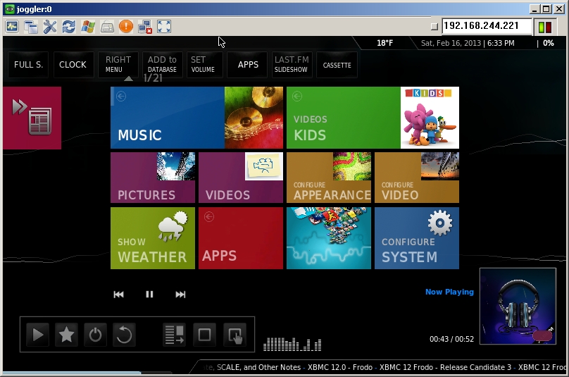

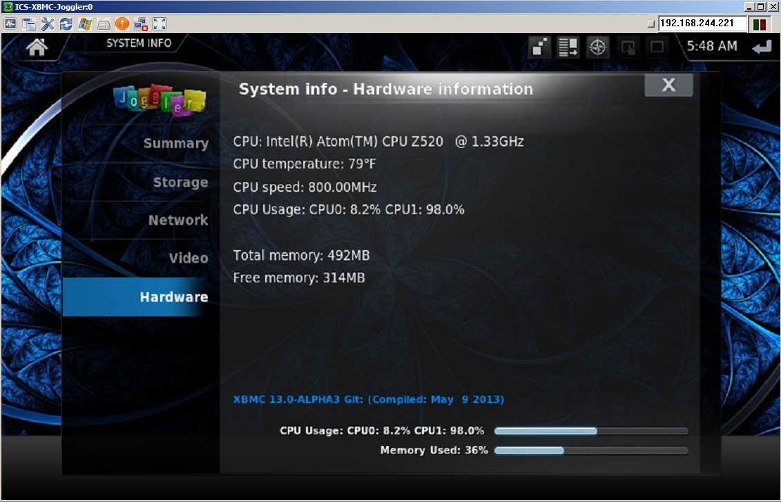

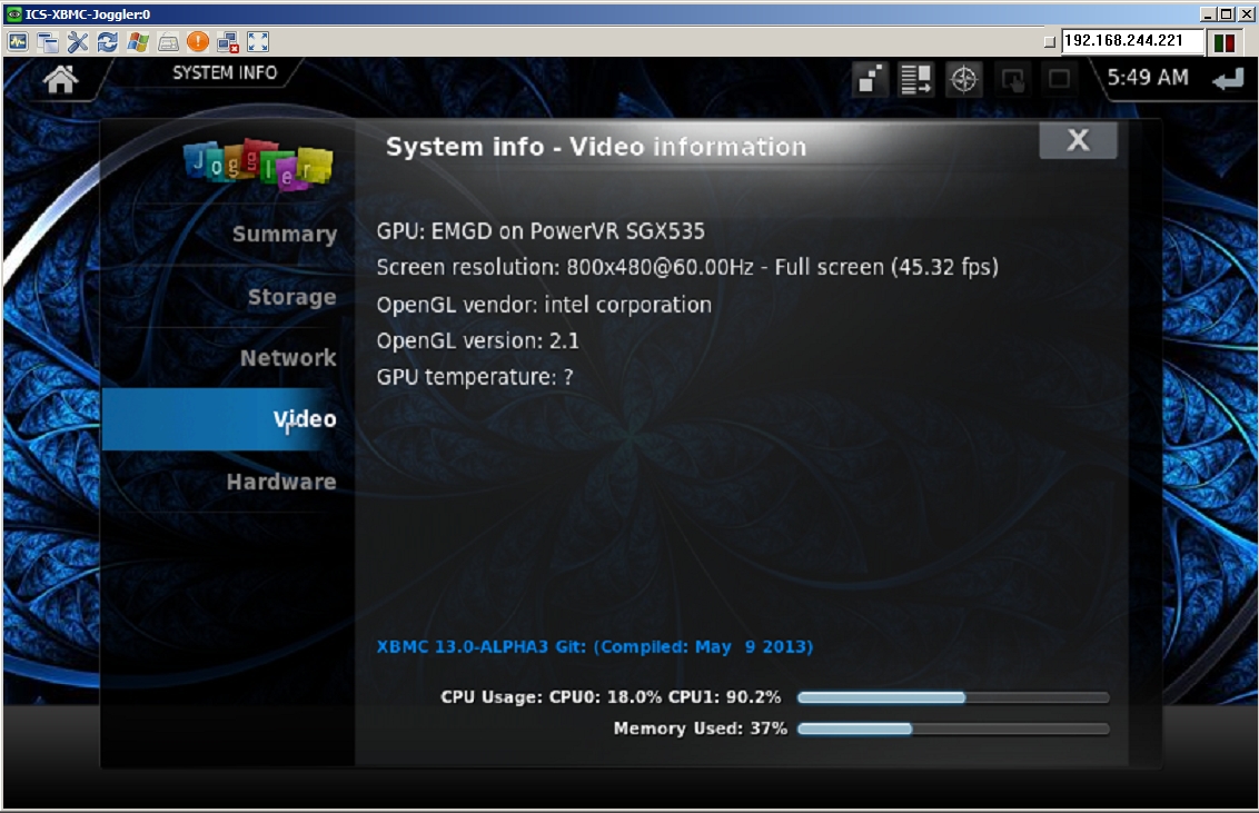

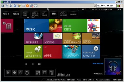

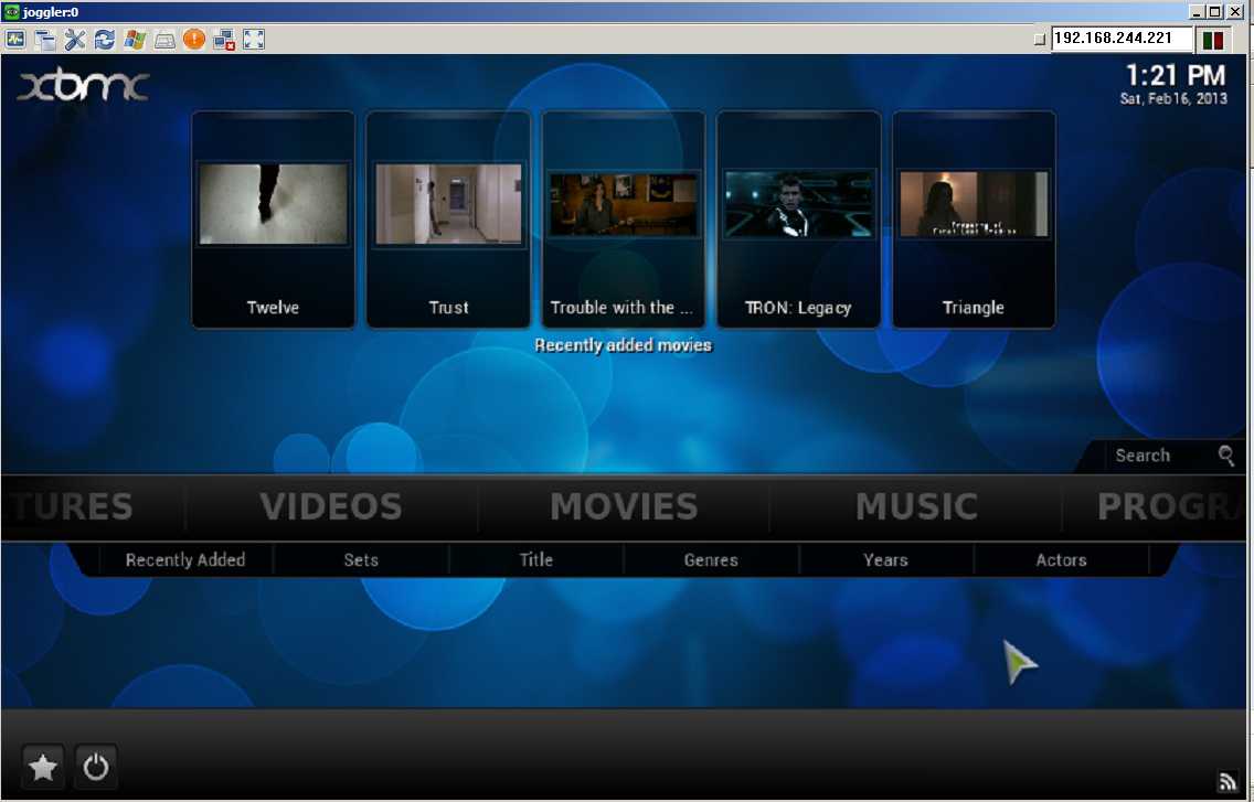

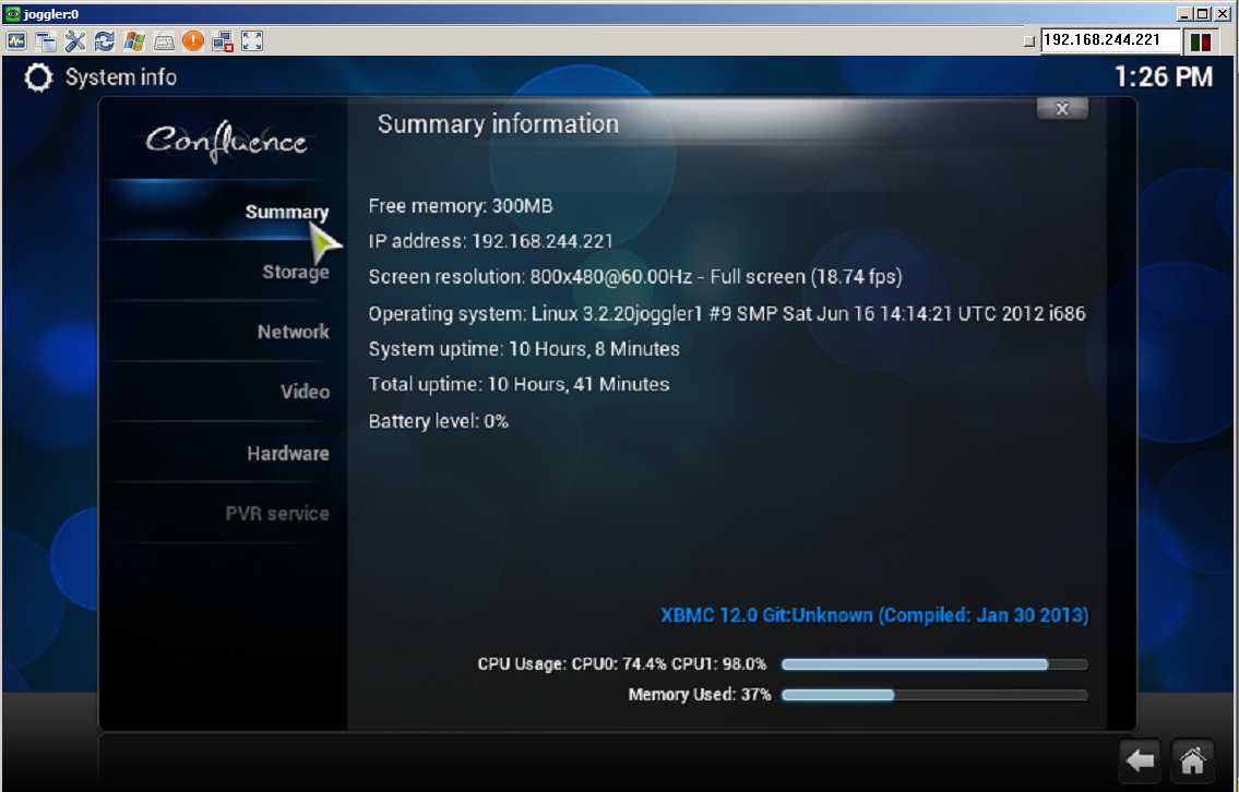

Yeah; its been working fine now for the last couple of days. It is fast or similiar to the USB stick. I have filled it up a few times so "joggling" plugins to make room. Yesterday I did install a home automation plugin plus a zoneminder plugin; both manually by just copying them over and rebooting; worked. It does well with video (NAS) and my PlayOnTV streaming stuff. Trying to get the MythTV DVR/Live TV streaming going but think I do not have enough space. Easy to fill it up. Attached are some VNC XBMC screen shots. For whatever reason it also appears that touch works a bit faster or is more sensitive. That said though the Openframe 2 I am playing with has been abused somewhat with a loose LCD and speaker cover. I think this is a phone hub one. I'm wondering if folks are just throwing these away as they become disfunctional and also wondering how many different ones were deployed as beta's or for real use?
