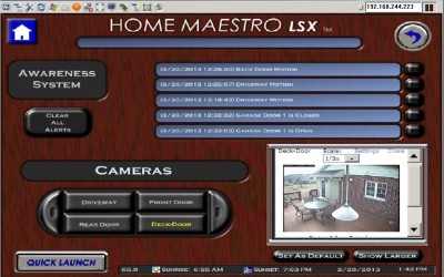

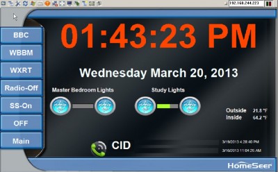

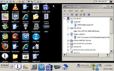

Here are some snapshots of the Joggler running Mevi's image that I am using for Home Automation stuff.
After I image the stick with Mevi's image I take it to Linux GParted and do a check. Most of the time I have seen that the boot piece (MBR) is not there; I set it with GParted and its fine afterwards. One new file I found that I needed for the Joggler was for the multiprocessor CPU which is named "ntkrpamp.exe". I just put this file in the windows\system32 directory and it works fine.
Using the Seabios/Coreboot and a USB hub works to boot just fine. Doing this with the EFI boot its a bit picky on the boot and I have less good luck booting. Relating just to the Joggler I have wired a 3rd USB port inside of the Joggler and use this to boot the USB SSD device. As the coreboot errors out with lack of resources for the built in Realtek network card I use an externally mounted Asix USB network device. I cut the wire; strip it a bit; solder it back together and plug it into the wireless USB port. This leaves me with one free external USB port which I can use for a mouse and keyboard attached to a USB hub. Easiest though to configure/boot in the Seabios mode is the SATA ZIF to SSD.
