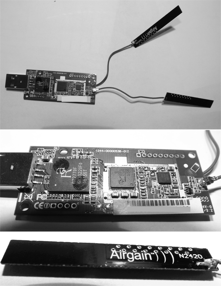

I will attach a picture of the two Joggler antennas and WLAN board here today. (pieces of Jogglers are all over my workbench these days). I've also had issues with the wireless.

Here is a picture of the wireless USB card and antennas. I've mostly just utilized the wireless with the PnP3'd Joggler, Squeezebox and XBMC.
You could improve the antennas a bit using a set made for a small laptop. Here I utilize a non broadcasting SSID, WPA and TKIP.
I've tried using a small USB wireless stick with antenna and that does work a bit better. Personally though I removed my wireless cards and replaced them a while ago with USB SSD sticks.
